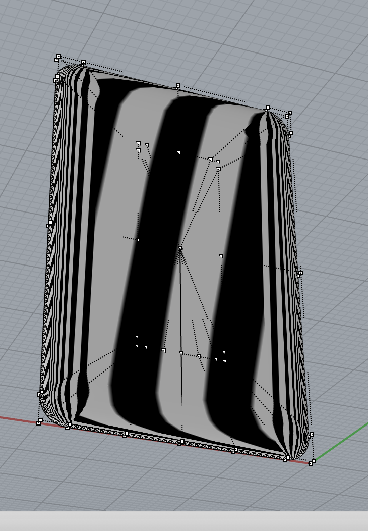

Perhaps I don’t understand the question, but here is the result using your lines joined in a particular way and Network Surface. The outside edges are planar and will cap into a solid.

Please see attached images. I joined the curves indicated by the common colors, selected all curves and ran the network surface command. The last image is what I was left with. I see your point about the surface flattening at the rounded corners, I’m wondering if additional guide lines or different positioning of those guide curves would improve that even more. I’ll do some more testing over the next few days to see if I can come up with something.

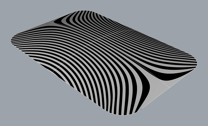

Hi Toshiaki - I’d built is something like this, not a surface but several, (I did not understand that from your original post).
Round_soft_surfaec_PG.3dm (98.4 KB)
Updated the file… I noticed I had not made the outer edges tangent to the vertical edges like the curves are.
BTW, looking at your base shape - I notice that the corner has a slight flattening of the curvature in the middle - I’d say to maintain really nice visually smoothly-progressing lines, there should only be one acceleration in curvature with maximum curvature in the middle, rather than two max curvatures - a small difference but it looks cleaner when reflections and light fall on it.
