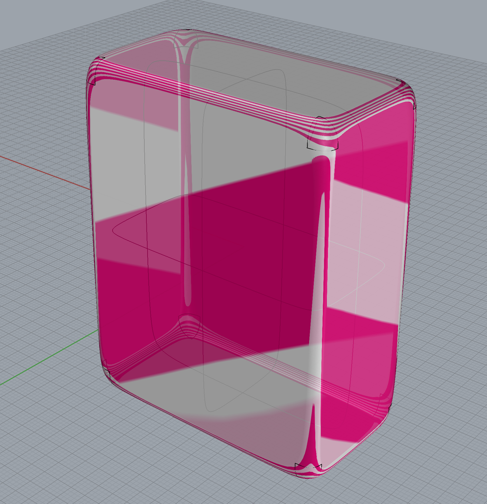

How to smoothly connect these surfaces?
I’ve tried Blend, Sweep, Network, Patch … with split edges. Noun of them really worked : (
How to Smoothly Connect the Surfaces.3dm (2.7 MB)
Update a satisfying result.
How to Smoothly Connect the Surfaces.3dm (4.2 MB)

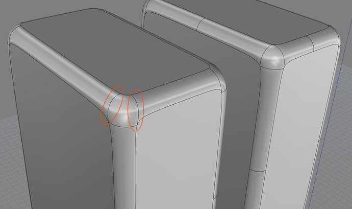

The rounded-rectangle surfaces have conic corners with rho set to 0.9, and they are tangent at the mid point of each edge. So basically the gap is a combination of 8 clean rounded corners, nothing else in-between corners. Therefore, I needed to figure out where to split the edges.
I did it like the image showed, for all the 6 faces (then realized I only needed to prepare for one corner…).
Then, I used Blend (and tried many times to adjust tangency or curvature to allow Patch to work better).
Then, cut the corner straight from each view, and Patch
Finally, I cut out one corner and mirror to the rest to get the acceptable result.
A result (not necessarily better) can be obtained with the NetworkSrf but with 4 edges (bend continuity on all sides except the top one that is position) instead of the patch.
You must use the “UntrimAll” command “keep all cuts” on the upper surface to retrieve the edges.
The attachment file contains the parts used to get the result.
How to Smoothly Connect the Surfaces.3dm (5.9 MB)
Any finishing … (to be applied manually on each edge of the parallelepiped. Otherwise, with the mirror there will be open edges.)

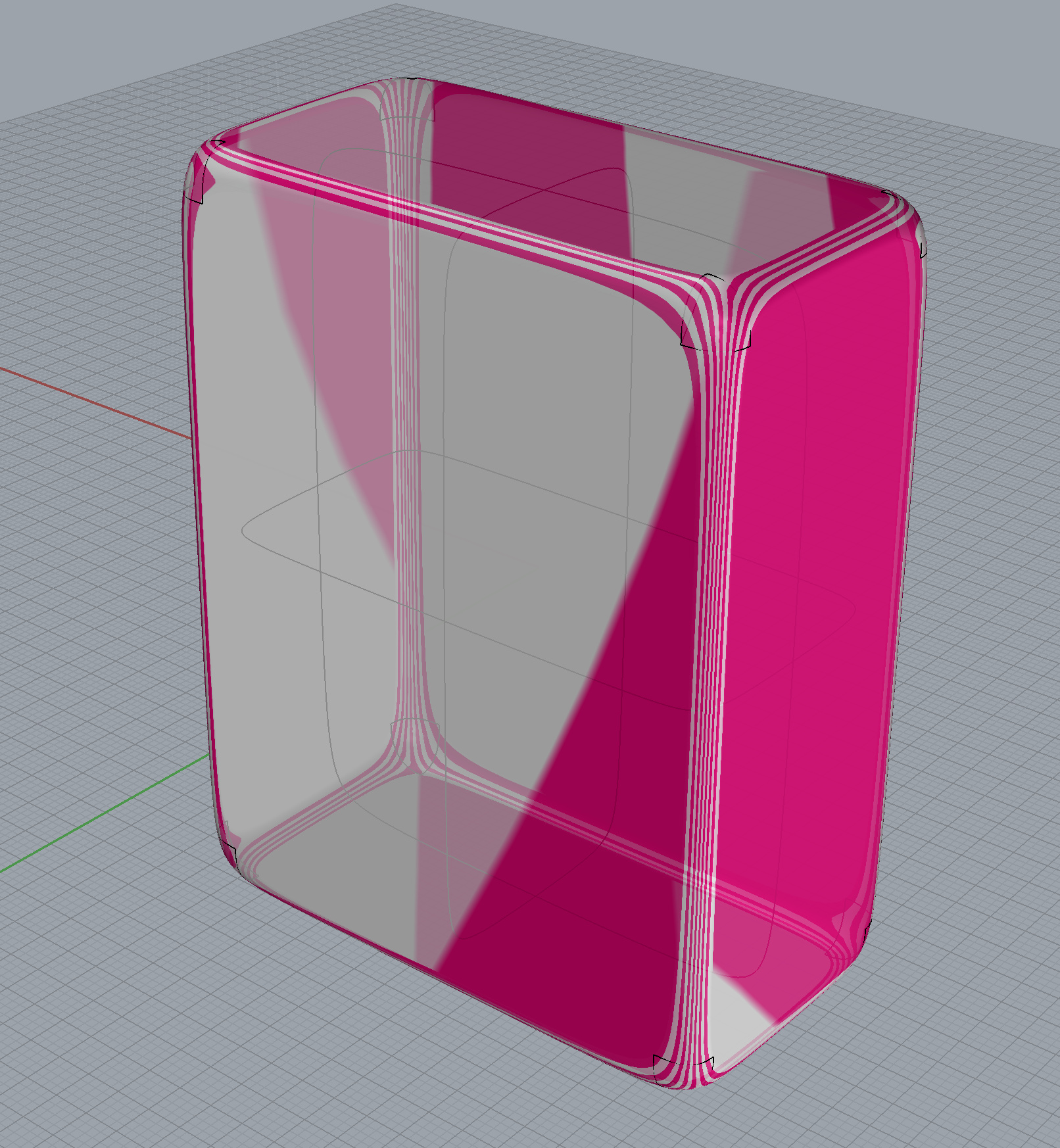

Hi Zhao,
for these “setback” corners, there is another solution, with G2 and less isocurves, often making for a better surface. Please find a quick take on a typical solution; maybe it is useful for your purpose (or anyone else, for that matter).

Hi @Lagom the surface looks great.
I also like to know as @Zsimon how you made the surfaces. Patch doesn’t join many times and solution to this kind of multiblend is appreciated.
You would use the Curve Network surface. You select G2 against the two already adjacent surfaces and the two lilac curves. Then you copy, paste and rotate the surface around the setback-cap’s centre (where the lilac curves are intersecting) to fill the void.
At last, some UVN control point massage is necessary.
