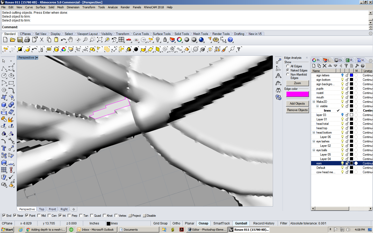

Hi Pascal
After doing a check for validity and show naked edges, I found two “holes” between the left ear and eyelash. I used Dupborder-patch-mesh-erase patch- join 3 meshes to have a mesh with no holes. It still gives me naked edges around the mesh patches I made. This will be “good enough” for milling it out, but is there a better way to fix the problem. I should have caught the problem at the beginning when I was drawing the original curves.
I can upload the file again if you would like to see it.
Thanks Kevin
Hi Kevin - just repeat the process - DupBorder would have left a curve there - extrude it .5, mesh, delete the extrusion and Join the mesh - this assumes there is a corresponding hole in the back face and you’ll get a ‘tunnel’ through the finisted mesh. If you don’t want the hole at all, FillMeshHoles on what you have,
