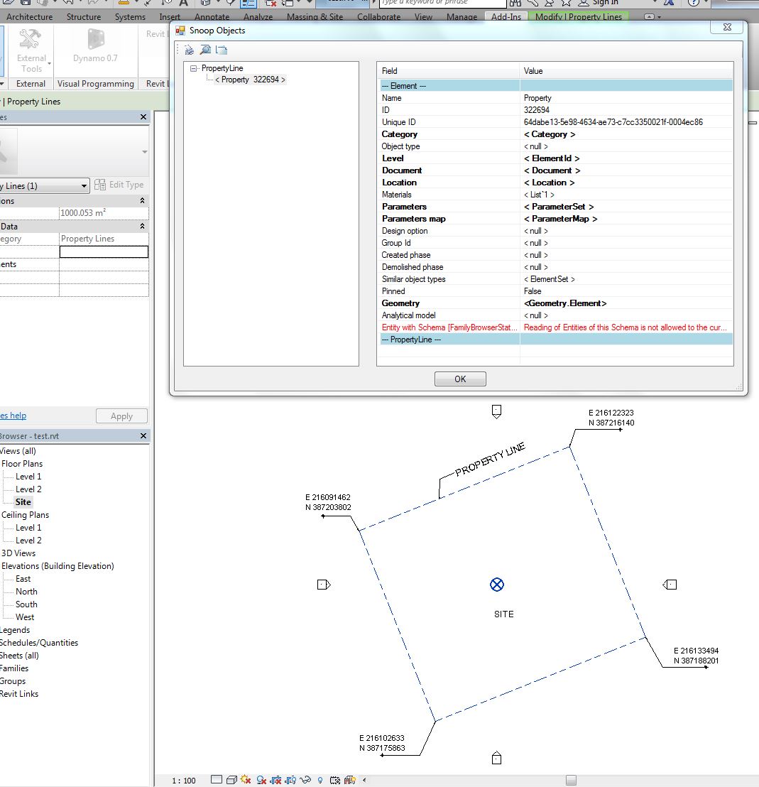

I’m looking to add property lines from a survey via Rhino.Inside. I’m aware I can just sketch over them but I’m trying to understand how much I can automate and this was one that came to mind.
I’d expect it under site but it’s not there, so I’m wondering if there’s another way to access it via Grasshopper nodes.
Thanks!
Scott
Hi Scott,
The Property Line isn’t well supported and doesn’t have a Create Method in the Revit API. Probably due to the option to Sketch or use Bearings when creating.
There is a wish list id in the thread below that you can add your vote.
