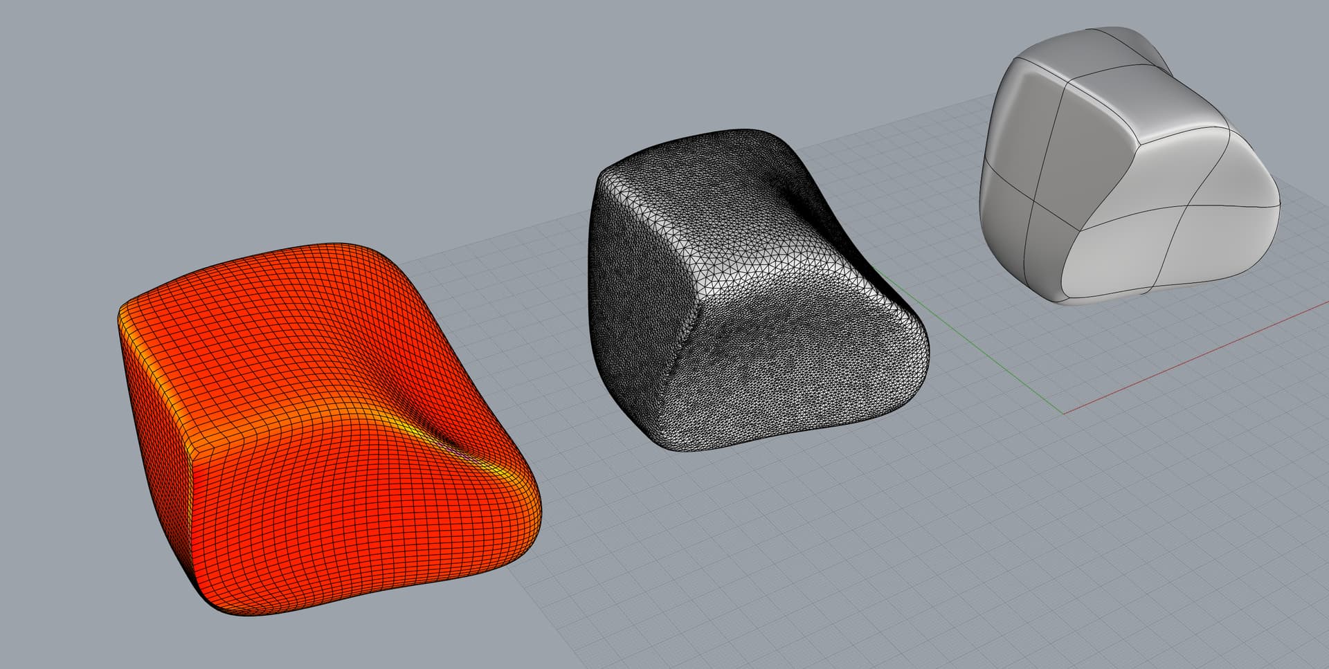

I love how TriRemesh doesn’t stupidly follow the Nurbs UVs like Rhino’s mesher and rather follows the topology of a shape.
Equilateral triangles hava all sorts of benefits, but I wonder if it would be possible to enhance thjis tool with an adaptive input, allowing to make smaller triangles in areas of strong curvature, similar to the QuadRemesh component ?

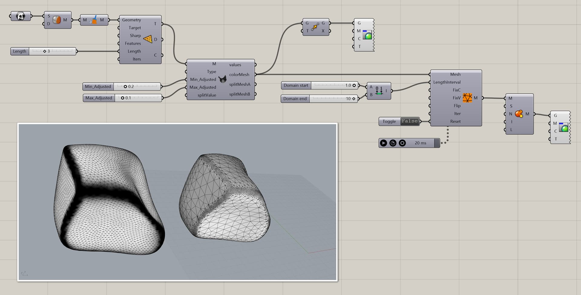

AdaptiveTriremesh_re.gh (15.5 KB)

I’ve gotten good results with the RemeshByColour component in Kangaroo. Gives you a lot of control as you can define the color by anything you want and thus gives you a little more fine grained control over the size of the triangles.
Thanks for pointing that. I strangely never use it.

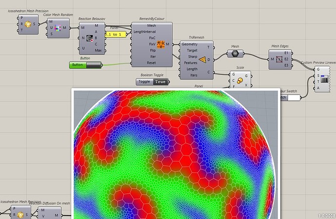

This work well with my plugin Nautilus as I output now color
Here with reaction diffusion
Belousov Zhabotinsky
Noise on mesh
Gradiant

Perhaps I have missed something, but with the same definition, I am unable to achieve the same result as shown above (and below)
In particular, the second image is of interest to me, as I am looking to create a sort of ngon structure (or hexagon tessellation) according to mesh slope (perhaps with a gradient).
I would greatly appreciate any useful suggestions or advice.
Thank you very much.
Hello
Perhaps I didn’t use the good component to make the RemeshByColor work , button could be better than boolean toggle and MUST be clicked to trigger the computation in Remesh By Color.
RemeshByColor.gh (20.9 KB)
Hope it helps !

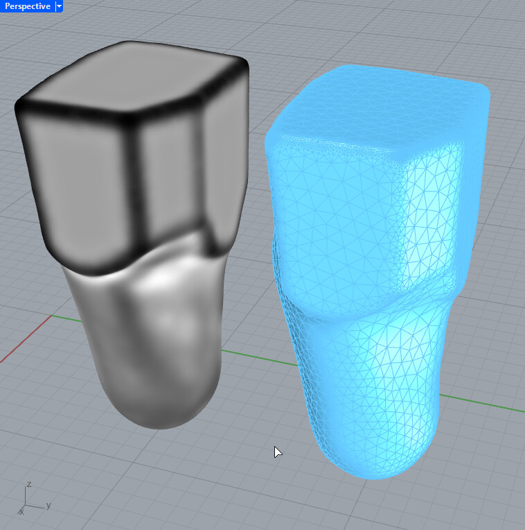

Remeshing by colour seems like a lot of fun, but I’m really interested in adaptive remeshing based on local curvature considerations.
Daniel, any timeframe for a “Tri-remesh” with this kind of feature ?
Using mesh curvature colors with Remesh by Color, this should be possible. I can get coarse in tight curvature but somehow fail to do the opposite.
