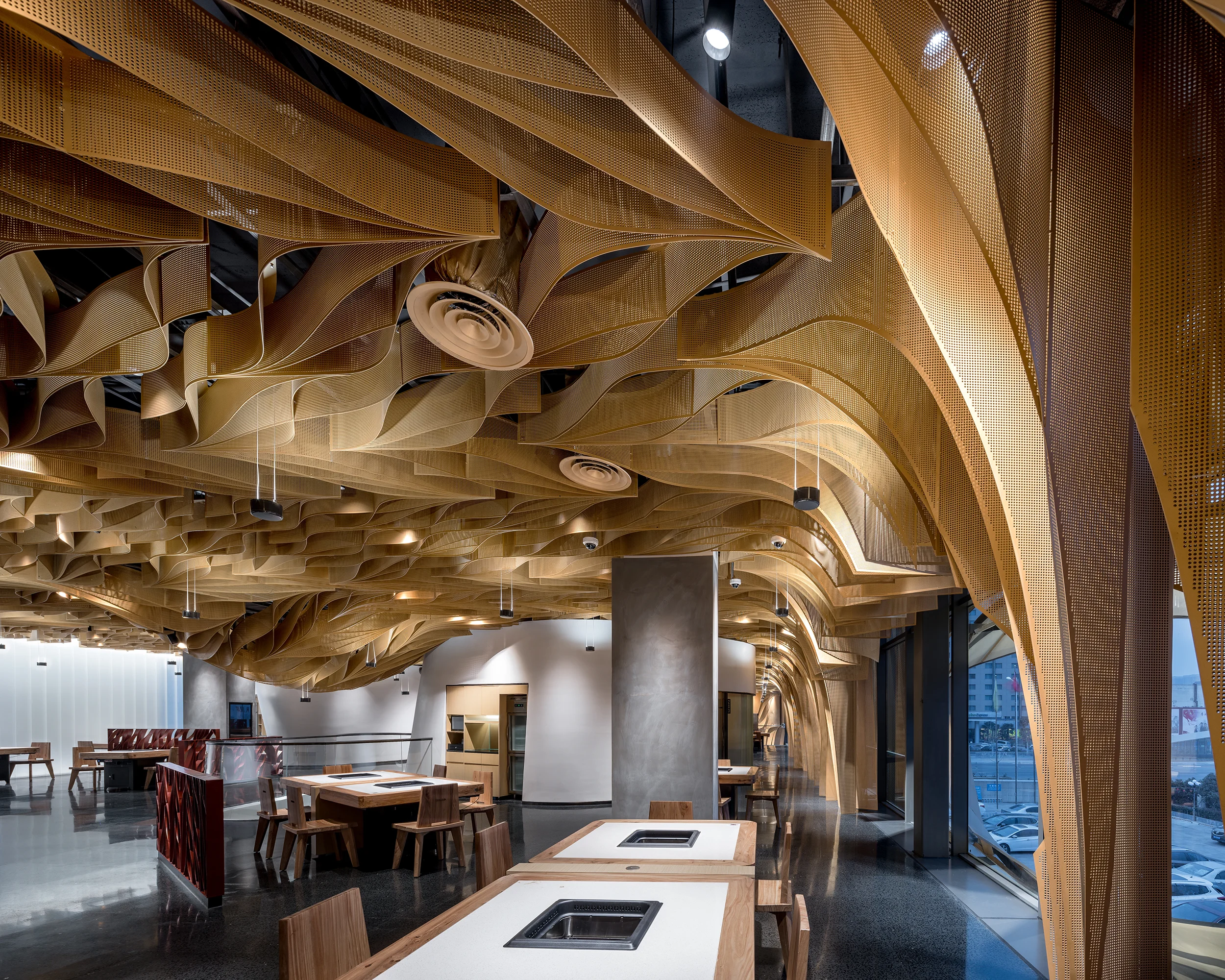

Hi @Javier_FQ,
Not exactly what you’re looking for but this pattern reminds me of Satoru Sugihara’s latest work for the ceiling of a restaurant in Zhengzhou, China.
Although he used Processing and his own library (IGeo) for the design you might find the following animated diagram interesting:

@lexi, it may remind you of Sugihara’s design, but it’s a completely different process.
