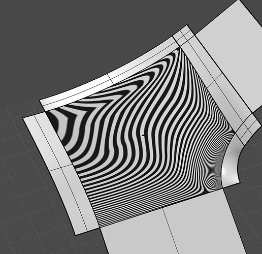

I am struggling to create a clean surface in this opening. Sweeps or patch do not yield the simple surface that I am after. I want it to be tangent to the adjacent surfaces and not trimmed. I have spent hours reviewing 36 Verts surfacing videos, but I’m just not finding a solution.
Any help or advise is greatly appreciated.
STRUGGLE BUS.3dm (119.2 KB)
that is impossible just to set your expectations straight, at least not a single surface. you have to divide it into a couple quadrilaterals. alternatively if you have access to Rhino WIp try FillSrf.

Ok. AS usual I was not paying attention - I was trying to work with FilletSrf, not FillSrf - so yes I see the controls now and can match your results, Thanks as always.
Gavin
Thanks Martin,
I didn’t even know that WIPs were a thing. Obviously this is a trimmed multi span surface and not a method of creating single span surfaces to fill the shape, but it definitely yields a way better result than patch or sweeps. I really appreciate your help.

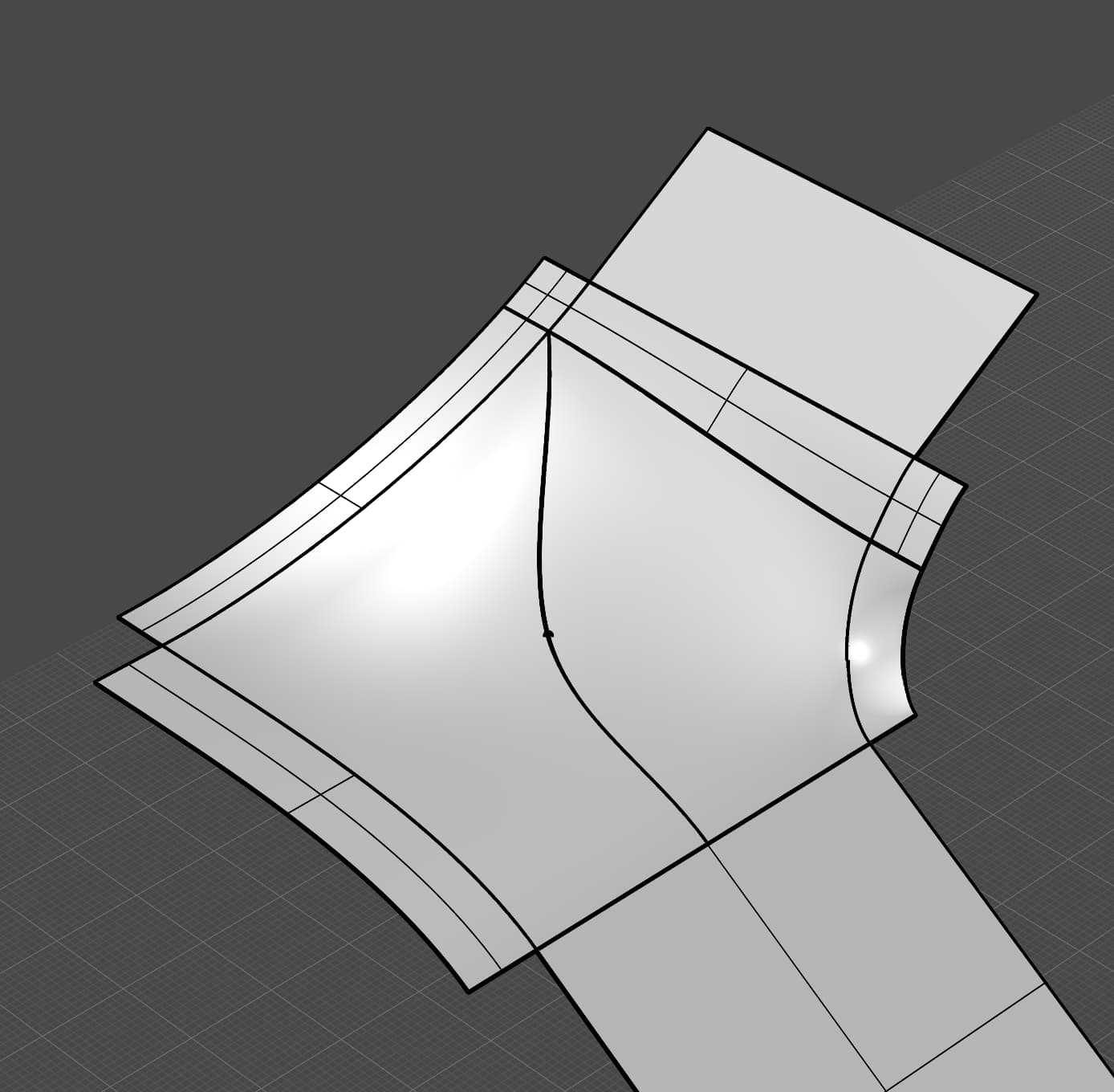

as i have mentioned above this is a thing of impossibility. NURBS Surfaces are always quadrilaterals. any surface that hast more or less than 4 boundaries is inherently trimmed, or in case of less you can also create singularities, but 5 sided untrimmed NURBS surfaces do simply not exist.
to be fair such 5 sided blends are always obnoxiously difficult to make with traditional non trimmed surfaces, it usually involves quite some experiences and a bit time. you can mess around on these things forever and still be a noob…

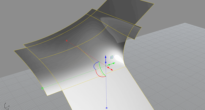

here is a very simple aproach with 2 quadrilaterals, if any of the more experienced nurbs doctors will see it they might start laughing, fortunately there are not so many around these days, which on the other side is also quite a bit unfortunate
i created 2 lofts and matched them with multiple, there is still a bit some matching to be done, and maybe you have to go back and rebuild once more but it looks like it could actually work out eventually.
no magic bus.3dm (103.5 KB)

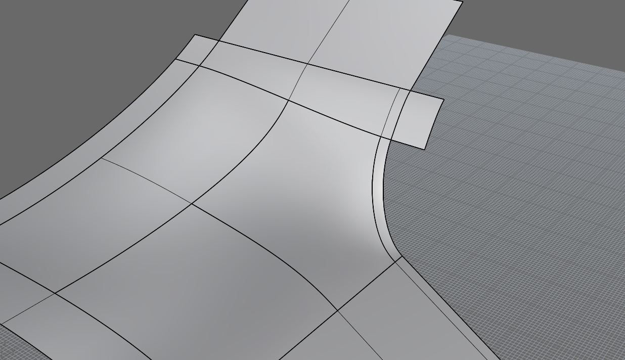

I think the constraints you have set for this surface are such that you’ll never get a satisfying surface no matter how long you try. The corner (Where the curve is drawn) has a nasty torsion. It would be useful to get a bit more context what you are designing.

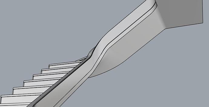

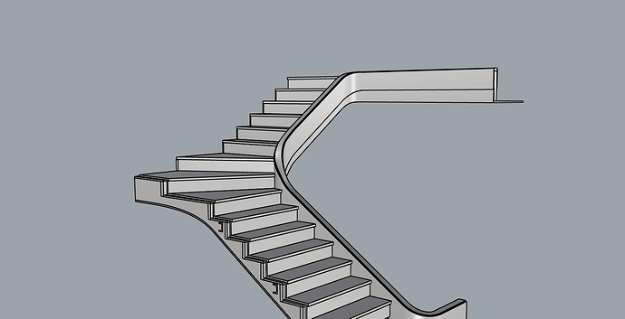

Winder staircase with radius corners.
pursuing untrimmed surface(s) for this is quite a waste of time
a solution, see if it suits you
STRUGGLE BUS_mod01.3dm (277.6 KB)
variant 2
