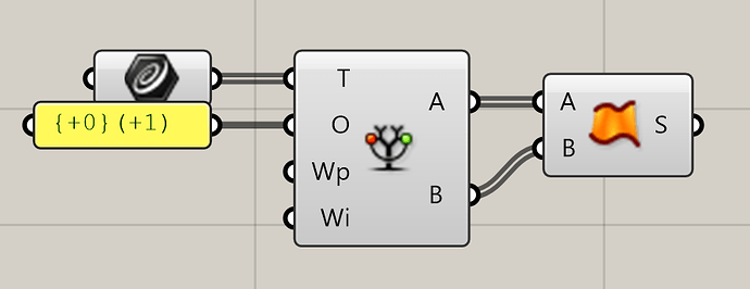

I am working on a terrain model and need to create a surface from contour lines.
I was thinking of using network surface and creating a grid with contour lines for one direction and curves perpendicular to this for the other direction.
To create these perpendicular curves I tried using curve closest point
However, in this way it would be necessary to repeat the command for each curve using the point created and the next curve each time.
I enclose an image and the script.
curve closest point recursive.gh (734.2 KB)
Is it possible to develop the commands recursively?
Or maybe any other ideas?
Thank you
Regards

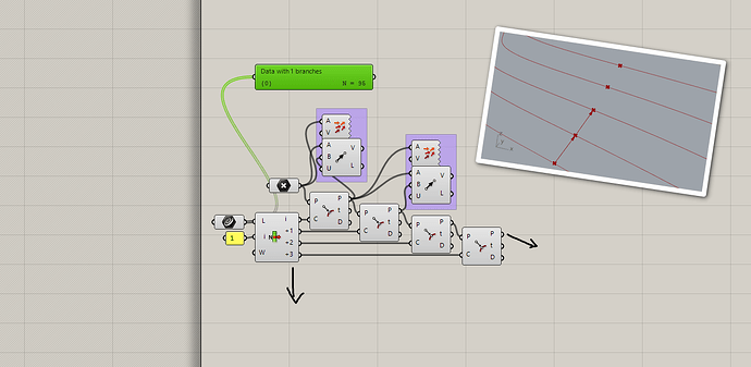

This isn’t a recursion problem. It’s a simple Shift Paths or Relative Item problem. Theoretically, the following works:
Only since you have open curves, you’re gonna get funky results. You’ll want a closed curve for every elevation. I began to try sorting the open curves by height in order to close them to the bounding area of your crop, but then realized that you’ve provided an incomplete curve set. Try getting that sorted out first.
Also, your control point density is way too high.

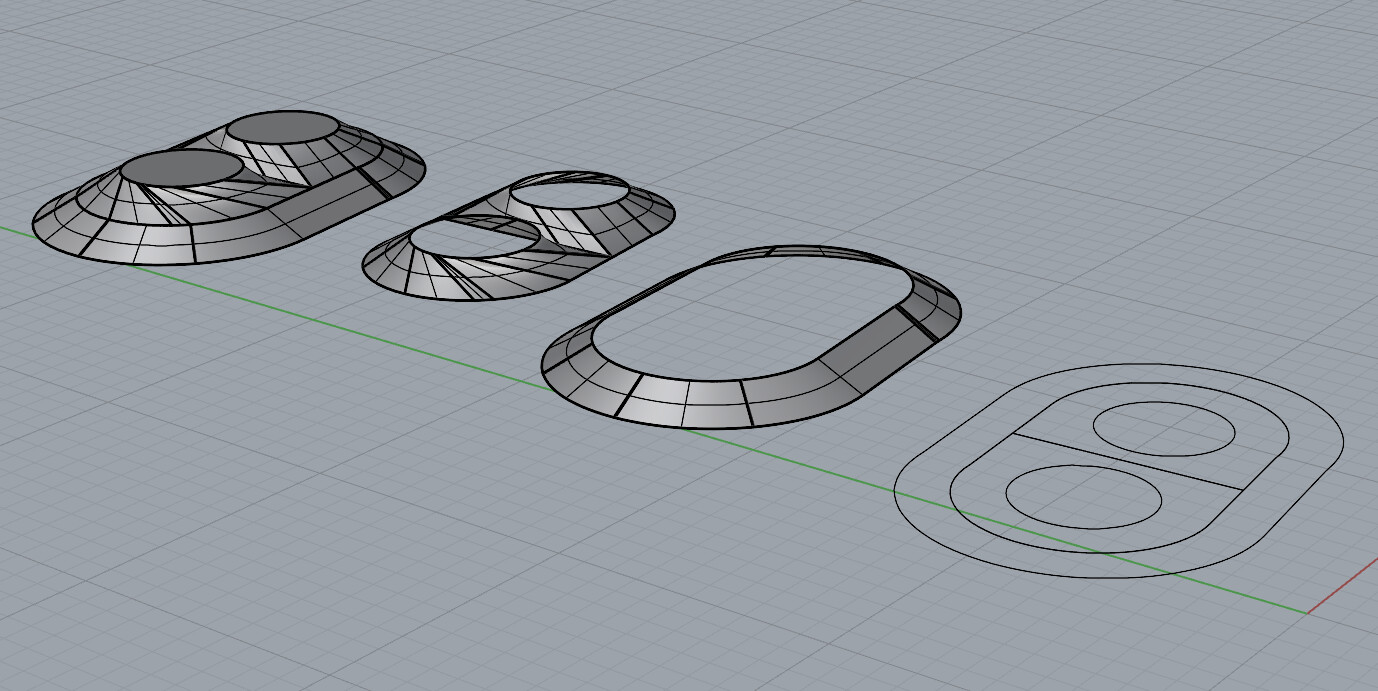

Well, then I’d argue, that you after getting your closed curves, you’d then have analzye them against their neighbours for the situation:
and then split them thusly into two touching curves:
You’ll have to use both versions of the curves for the loft/ruled surface/whatever method.
… Something like that. I dunno. Lofting or always seems to go awry when the profiles have different curve degree and do not have their control points placed closest point across from each other.

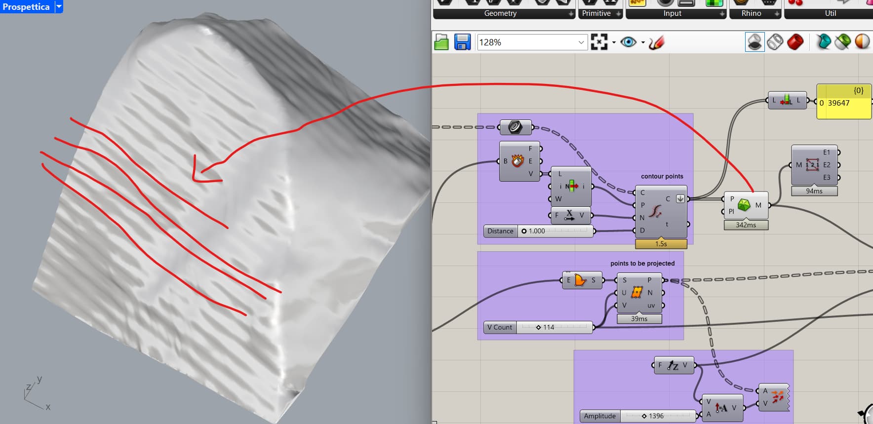

I worked on this script today and managed to achieve a satisfactory result.
I constructed a mesh and then a surface using this mesh.
And then everything else
you could improve the curve reconstruction step, but in this case it still works

I first created the ground surface by creating a mesh of points. then it is possible to build a surface on a mesh in various ways
In any case, I am interested in other possible solutions because this was a specific case, but maybe it does not always work
In my experience, mesh patch works pretty well to create geometry from contour lines that may be open or closed. If you need a surface, then you can drape across the mesh. Another alternative is to quad-remesh the mesh patch and use the quad-remesh as input for subd.
Keep in mind that you should extend the contours beyond the edges of your site and trim the resulting geometry to your site boundaries once you are satisfied with the result.
What do you mean with mesh patch?
Mesh from point?
Have you got some exemples of scripts with quad-remesh and subdvs? I think You mean with weavebird
Anyway in this case i think the results of the surface Is quite good. I also think that the surface Is a bit strange, due to the mesh, and the original points/polilynes. If you see my script, you can see. they are distributed like a wave or something like that.
