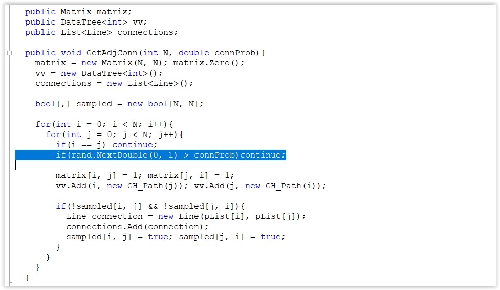

BTW: A “similar” approach is used in the 1st C# (option: random connections acc a random probability naive/stupid user value/rule):
BTW: obviously the pro way to cut the mustard is to define a custom Class where suitable properties are assosiated to each Point and thus the DoConnection (i.e. connect) would deal with some pragmatic rules for declaring a connection as valid. If your points are male and female then, say, use for Properties: an IsFemale bool, plus an HowPrettyIsShe int , plus an IsMarried bool , plus an DoesSheLivesInThisPlanet bool, plus WhatBikeSheRides string … blah, blah).
BTW: Since the Graph part is solved (and the K2 as well - we can add/use any Goal imaginable [existed or custom for the occasion]) … post here your rules (or some rules). This is the core of the matter … the rest are elementary.
