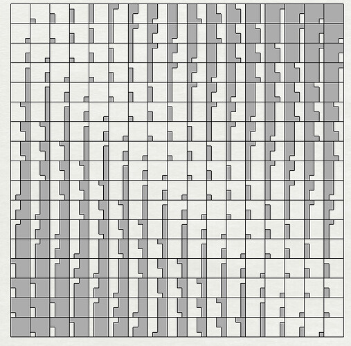

Hello guys!
I am fairly new to Grasshopper, and I’m trying to create a 2D matrix, or grid, with constrasting shapes that have specific variables shifting from one column/row to the other. This could be either in size, angle, etc. My first steps were trying to play around with the components, but that has led me nowhere. I looked around on the internet for some tutorials, but that wasn’t successful either since all of them were working in a 3Dimensional manner. All I need is some simple 2D lines where I can export to Illustrator and post-produce. I have attached some images of what I’m trying to achieve.
Any help is greatly appreciated. Thank you!
Here is an idea for the circles pattern
The basic principle is to build an array on rows/columns, that would be a two-level DataTree in Grasshopper. And store all parameters (angles in this case) in a data tree that has the same structure. From there, use simple geometric components to draw curves/surfaces.
CirclePattern.gh (16.4 KB)
TrianglePattern.gh (21.1 KB)
Thank you so much!! You’re a life saver. Is there any component I could change to have a different pattern that behaves in the same way? Just to kind of come up with something original.
Yes you can vary the amount of rows/columns, and the min/max angles of the arcs.
You could also add a Scale component at the end to have the circles vary in size…
You could have the main rotation axis (135°) not being constant…
Replace the arcs by triangles…
If you are completely new to this, maybe start with a pattern along a single line to practice.
That last pattern was a math nightmare !
TetrisPattern.gh (15.9 KB)
CirclePattern2.gh (21.0 KB)
