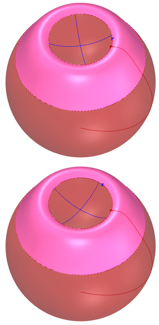

I got it to work in the same way, thanks, having Googled curve blend code.
However, I now have no control over the direction of the patch alignment like the native Rhino command affords, nor do I have manual control so far since I don’t know if it’s possible to change the target surface effectively:
Changing the brep edge closed curve seam point doesn’t seems to work.

to reverse the blend direction, you have the True/False toggles for each end.
You would either use _SplitEdge and _MergeEdge so the seam is close to the one of the spherical brep or alternatively untrim the patch first, change the seam point of the trim curve and re-trim. Below is one example using a patch surface similar like yours.

SplitEdge indeed introduces a new endpoint viewable with ShowEdges and manually using MergeEdge in Rhino can get rid of the original point, but I only see Split available for brep edges in Rhinocommon, no merge/join command, nor am I sure how I’d control which point got nuked, and frankly I can’t tell how Rhino is choosing which point to keep either with MergeEdge.
There’s also ChangeClosedCurveSeam and SetEndPoint listed under BrepEdge, but they return False when I print them in Python so don’t seem to work.
http://developer.rhino3d.com/api/RhinoCommon/html/T_Rhino_Geometry_BrepEdge.htm
I do confirm endpoint change using Rhino’s CrvSeam command on a trimming curve used to re-trim an untrimmed surface. I guess Rhinocommon just doesn’t work like it should to change the seam of an existing brep edge?

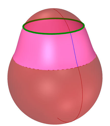

However, I have a glitch in that depending on the angle of the little guy and its re-trimming curve, I’m getting not one brep face edge curve but often three, so I get a gap in my blend surface:
There doesn’t seem to be a merge command in Rhinocommon equivalent to Rhino MergeEdge. Maybe I in fact do have to build a brep from scratch, old school?

Tom Jankowski just released a new plug-in, Advanced Surface Tools, that features his own blend code:
So far it can’t handle this system except by splitting it into quadrants.
