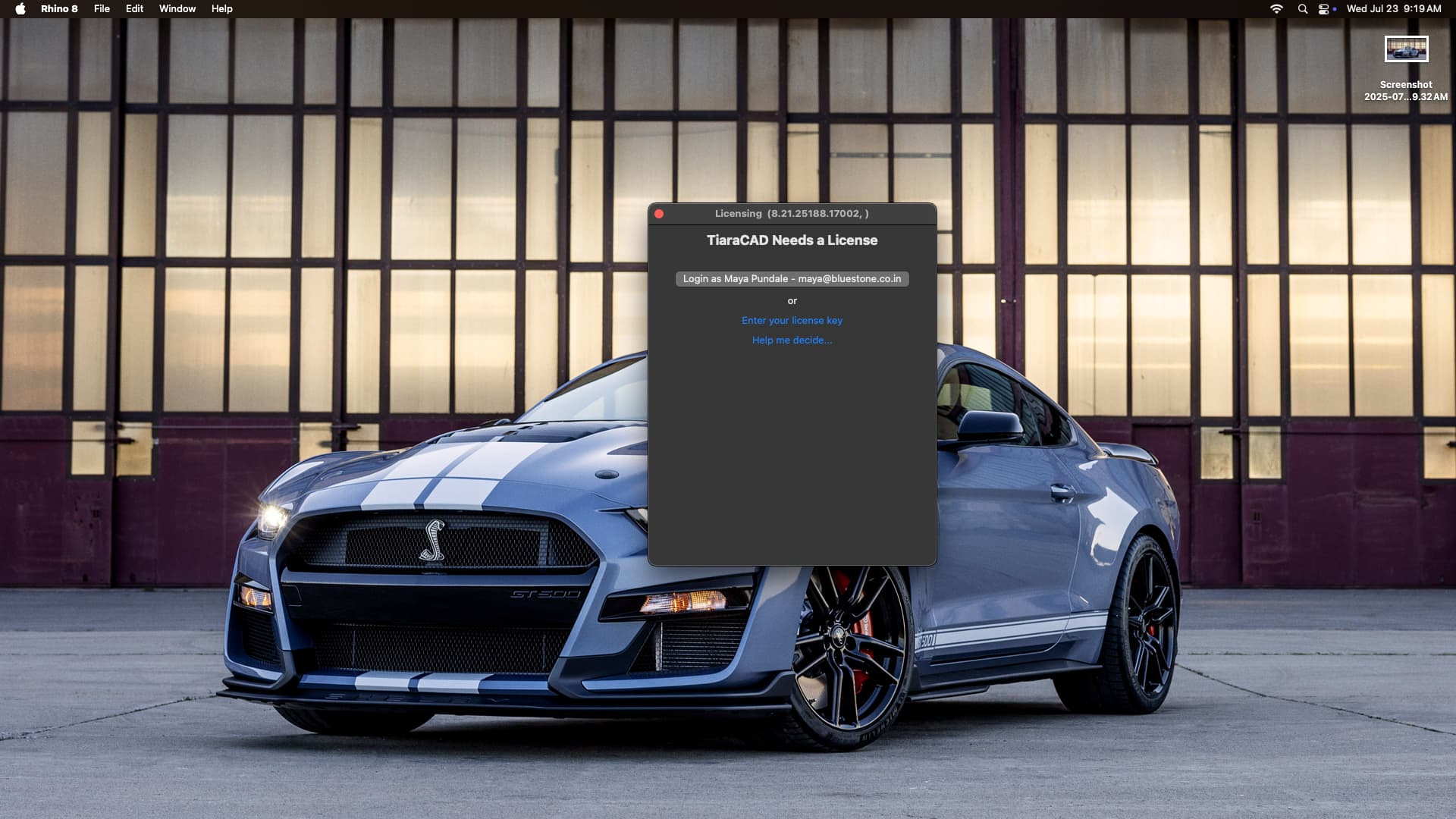

Hi @maya_puundale, could you please share a screenshot of the error that you’re getting when trying to load your plug-in and get a license from Cloud Zoo on macOS?
Hi @will

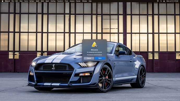

I have attached the screenshots. First it asks to log into Rhino Cloud as we have enabled it.
However, the error comes next.
It works fine in Windows.
The .pfx from McNeel signs the Windows .rhp using signtool.exe
While for Mac, we don’t know how to sign.
Are we missing something?
Thanks for the screenshots! This error means that Cloud Zoo can’t find a product that matches the plug-in’s ID. It sounds like your Mac plug-in currently uses a different plug-in ID than your Windows plug-in. I noticed also that your product on Cloud Zoo is marked as Windows-only.
