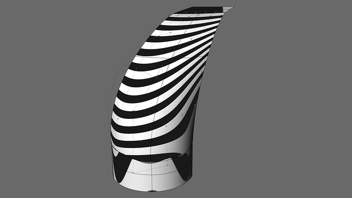

@XNurbs I have been very impressed with your efforts and help so far to improve XNurbs, but the tone of the last couple of posts especially towards @Rhino_Bulgaria makes me want to flag these posts as being very aggressive. I studied his surface created with plain Rhino tools and must confess that the flow of the result created by XNurbs doesn’t match it. I tried both 1.42 and 2.0 but get similar (though somewhat different) results. The Xnurbs results are more dense:
also the curvature graph reveals that the flow of the surface isn’t as fluid:
I did notice the imperfections too in the videos pointed out, especially the bumper. I don’t think it is a limitation of version 1.x though, but rather a constraints issue, that can only be solved by gradually refining the model. I interpreted that video rather as a workflow video though instead of that the video should show a ‘perfect’ model.
I am interested to see as well if we can now come closer to a perfect model with the additional options in v2.0/2.1 So if @Vladimir_Aleksic would be so kind to share the bumper model, we could al learn and improve future versions of XNurbs.

@XNurbs. Thanks for sharing this. I downloaded the model and I believe this is close to what I asked for. I see the surface is a degree 5 surface. A question I have is with regards to respecting input geometry.
If a four sided input is for example degree 3 in the U direction and degree 5 in the V direction will it respect the input geometry? So the output would be a surface with degree 3 in U and degree 5 in V, or will it always build a single span degree 5 surface in both U and V.
Regardless, I believe this would be a great option to have since you can build very clean concept surfaces. The fact that thay may not match 100% is not always critical in the concept phase (at least not for me). In addition to this. If the concept surfaces are only a positional match with a blend to be build later they don’t even need to be position. If they are close I will trim away the edges anyway to build the secondary blend in between.
Looking forward to try this when released. Thanks.
I think that XNurbs version 1.x did a better job. Showing the control points of the Xnurbs patch made with version 2.x reveals some chaotic arrangement.
This isn’t the case. At loose settings 1.x produces similar results. See also this post:
I said that XNurbs 1.x did a better job previously with the same input surfaces, because the latest example is basically G00 (out of tolerance) and for some unknown reason it produced a patch with strange chaotic distribution of the control points.
I thought you were merely referring to the chaotic points. I don’t have access to the computer where I use XNurbs on right now, but I kept all versions of XNurbs installers. When I get a chance I will try this sample with earlier versions and post back the results.

I see some different results happening from XNurbs 1.40 and later revisions, but none of them builds a surface with evenly distributed control points. While version 2.1 shows improvements, Rhino’s native “Blend surface” is still much better.
That won’t happen. Autodesk doesn’t need another patch command.
Maybe the control point structure doesn’t look very nice, but you cannot really compare it to a Rhino BlendSrf, since those are degree 3 in the direction perpendicular to the blend direction. Since this is a degree 5 single span you can see even in version 1.x it is still a smooth result and 2.1 seems to be a vast improvement.
That being said, I agree it would be nice if XNurbs could generate something that comes more close to this:
loose-loft rebuild.3dm (899.0 KB)
