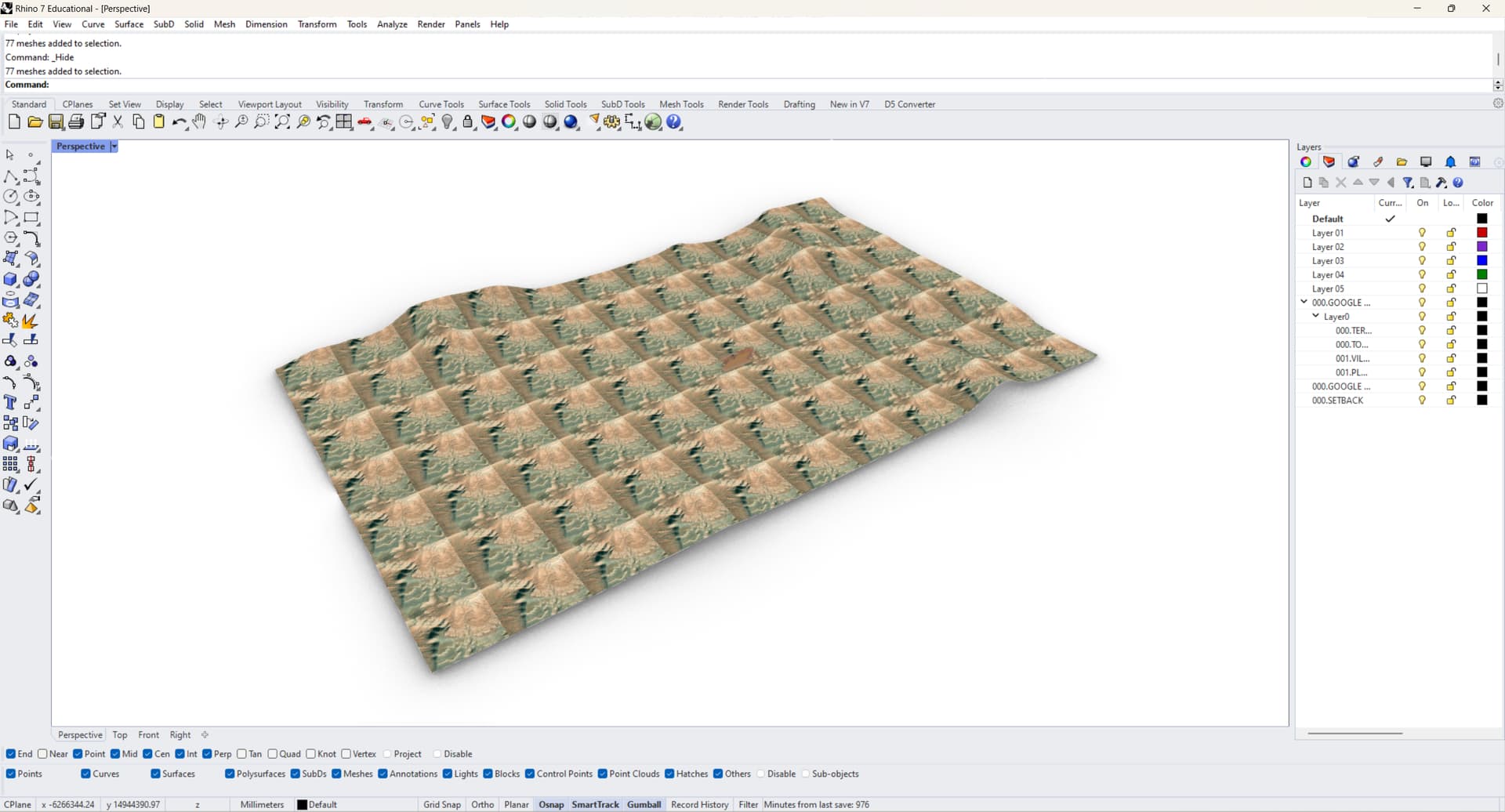

I imported a Sketchup model into Rhino (I tried both Rhino 7 and Rhino 8), and the image mapping is not oriented and scaled correctly.
I would be very grateful if someone knew how to handle this :slightly_smiling_face:
Hi Jonathan -
Issue RH-69604 was fixed in Rhino 8 during the beta phase.
In the notes, I see that you’d have to run TestClearRDKCaches before importing the SketchUp file.
If that doesn’t work, please post the SketchUp file that you are having issues with.

I am not sure if I ran TestClearRDKCaches correctly. I typed it into the command line and it showed 0 files deleted. (I am not a very experienced user :sweat_smile:) However, the import result was the same.
The skp file is a typical geolocation terrain model, but the size is about 100MB, which exceeds the limit to upload, so I share it with the link below.
Hi Jonathan -
Thanks for that file, I’m seeing the same here.
Could you add an image of how that looks in SketchUp? (as this clearly is not the same dataset as the one that you posted images of).
I’ve put this issue on the list as RH-79599 File IO: SketchUp: Incorrect texture mapping scale
