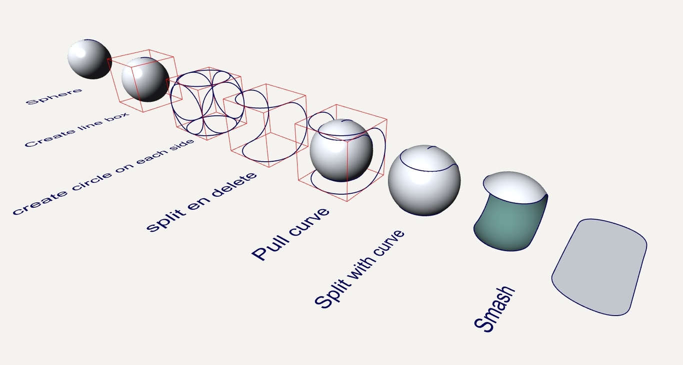

Wondering if there is a way to figure out or a routine that findsSample Surface.3dm (860.2 KB) the shapes that would be cut from a flat material(veneer) into a shape that could wrap an object like a baseball. I work with wood veneer and have a project that has multiple curved nurb surfaces in wall panels. I think the shapes of the individual leaves of veneer need to be cut into shapes like hour glasses, in order for them to be applied. I would need those shapes then flatten or unrolled correctly so we can cut them on a laser. I’m not sure if the extracted isocurves could work for us in that way.

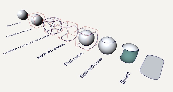

What i understand, you should do like this way if i misunderstood, skip it.
one faster method :slight_smile:

Or did I fail to realize that “TestBaseball” is the command I’m trying to describe and not just what you decided to label your starting object, @Gijs ?
it is

What I understand, you try to cut the shape of a baseball out of your object, if so, this would be my answer, but as @John_Brock and @jeremy5 say that wood veneer won’t distort, you can experiment a lot to get a good shape to wrap. And I’m not that good with differences between baseball and honkball.
