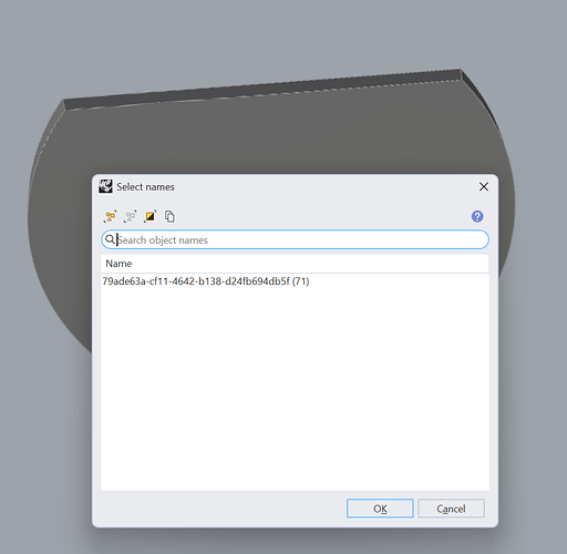

Is the searchbox implemented already? I don’t have Rhino 9 WIP and can’t check by myself.
Also, name grouping by same name and number of copies inside brackets? This could work best by adding a new tickbox called “Group by name” or “Group same names” (not to be confused with the actual _Group command in Rhino).
The new pop-up window looks so much useful now! :slight_smile: Great work!
I just edited my post above to add another question. :slight_smile:

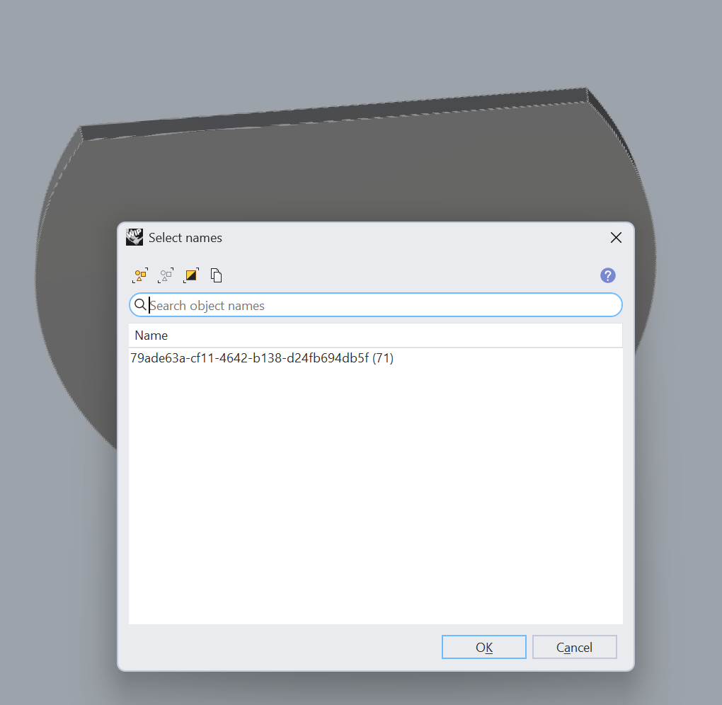

For my liking, the default minimum width is too wide.
Here with a guid

Could it be set to a narrower size, but taking 80% of the screen’s height instead? I mostly need vertical space, not horizontal.

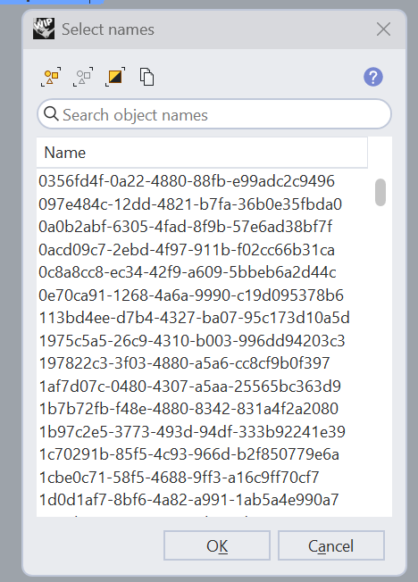

I just made PR that fixes that. min. width becomes 300 (was 500). It will stay 500 for SelBlockInstanceNamed. It will also make the content scrollable.
this is min size:
When scrolling, type a first character and it would autoscroll to the first name with that character would be nice
