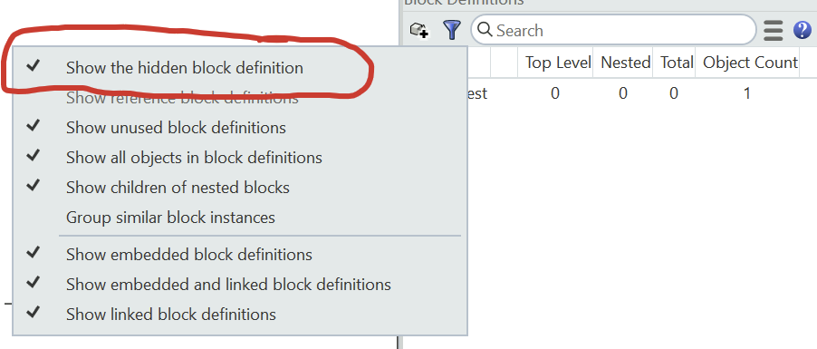

If we could just do something similar to how the block manager handles this
Right now it is possible to hide User Text as well as Block Definitions in Rhino by using the ‘.’ and ‘*’ prefix for both of them respectively. This is helpful as it ensures (mostly) reliable data flow between rhino and grasshopper if i am relying on certain layers being there in the .3dm file at all times.
Similar functionality would be nice for layers - to be able to add a single prefix to keep layers hidden such that a rhino user wouldn’t unknowingly tamper with them.
