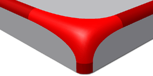

This example does not show fillet of type “setbacks” but I’d like that one day Rhino could automatically resolve these situations without having to do everything by hand. Watch the last part of the video if you like.
(If I can find examples of fillet setbacks will place them here). Thanks.
The blend surface consists of 7 edges, I can only achieve it with the plug-in “VSR shape modeling” using the “Multi blend”, otherwise with the patch of Rhino you can not implement well.
The result is this. Maybe you could do better, I do not know …
