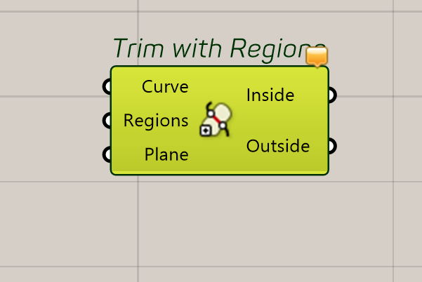

231113_IMG_Delete consecutive
I need to filter a list in parallel with the one in which I weed out consecutive elements.
A simple index output would allow this, and make the component actually useful, and not just pretty.
I agree, it can be very useful to count consecutive similar values, for example to change a one-to-one data match to a one-to-many match (e.g. for Trim with Regions).
