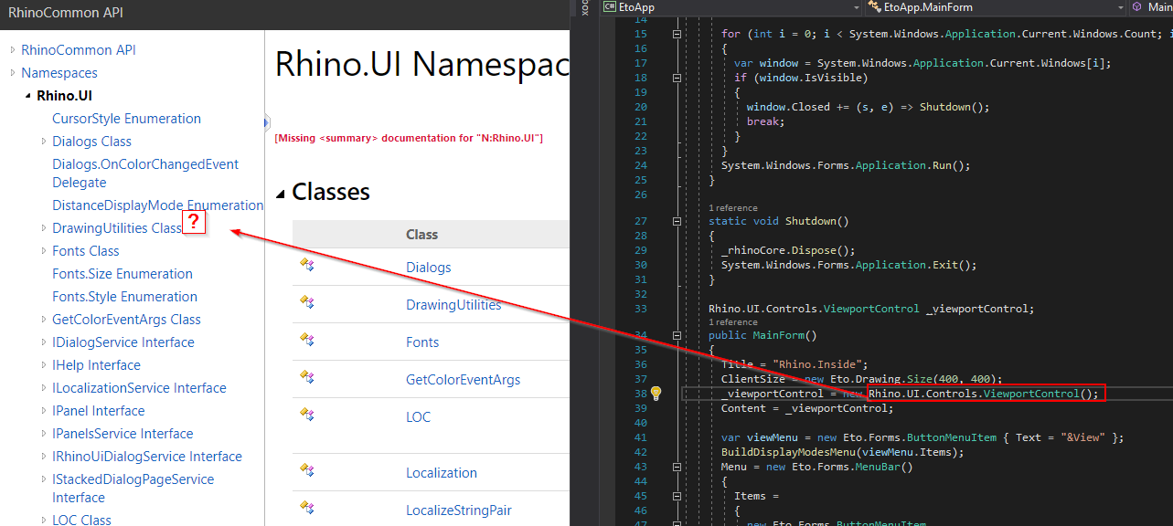

The class is not in the RhinoCommon documentation, as it does not exist in the RhinoCommon.dl.
The ViewportControl is a Eto.Forms.Control, so look at that documentation for the input events.
The ViewportControl has one property: Viewport
, which gives you a RhinoViewport
. Eto documentation is linked to from the API page
Anyway, I’ve logged RH-65901 Publish Rhino.UI.ViewportControl documentation.

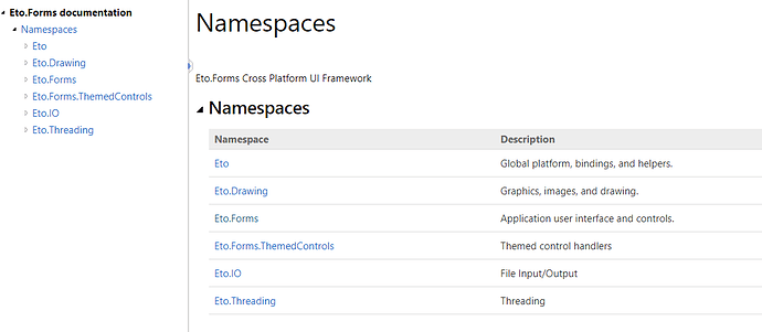

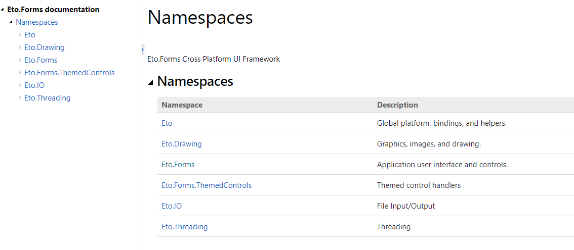

I also checked Eto documentation. No controls there either:
unless you mean this:

When I say it is a Eto.Forms.Control
it means the control derives from the class Eto.Forms.Control
. Look at the documentation of that class. Rhino.UI.ViewportControl
inherits the public API of the control it inherits.
if only there was Rhino.UI.Viewport… in the documentation. I was looking for it as well. no V* classes
Unfortunately, that goes beyond my “script-kiddie in transition” skills. I need a working example to build on top of it. In the example there isn’t even the left-click-pan implementation. Feels like there is a hidden implementation.
