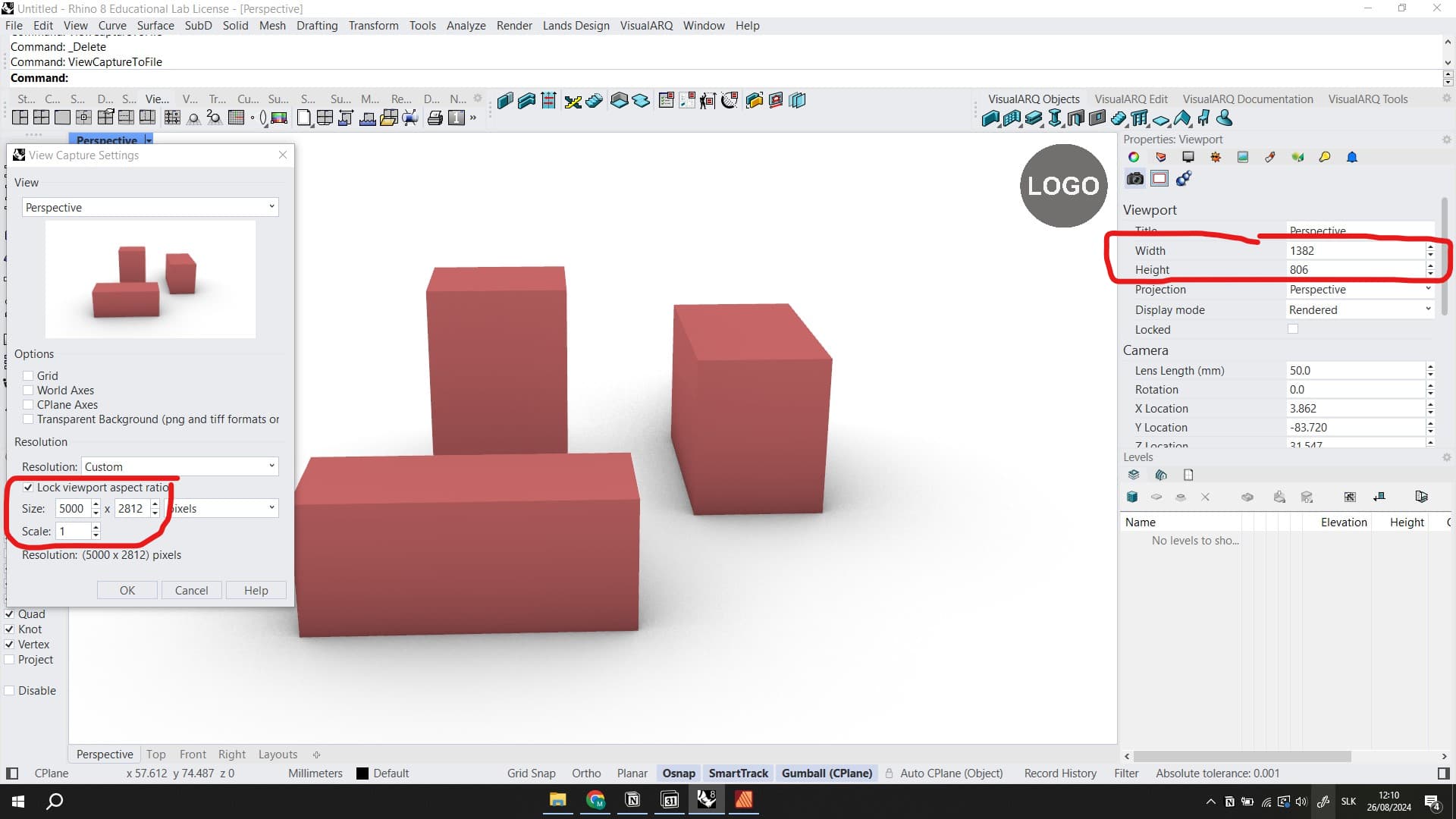

hi @Holo, I just tested it. Here is working well here, some feedback:
  1. It the preview of Viewcapture to file the logo looks huge, but the resulting viewcapture looks fine:
  2. If a logo is applied and you use the command LogoViewports nothing happens. I think it should be used to override the existing placed logo with a new logo. Also when you do this the position and size you were replacing should be saved as defaults, instead of asking you all over for position and size.

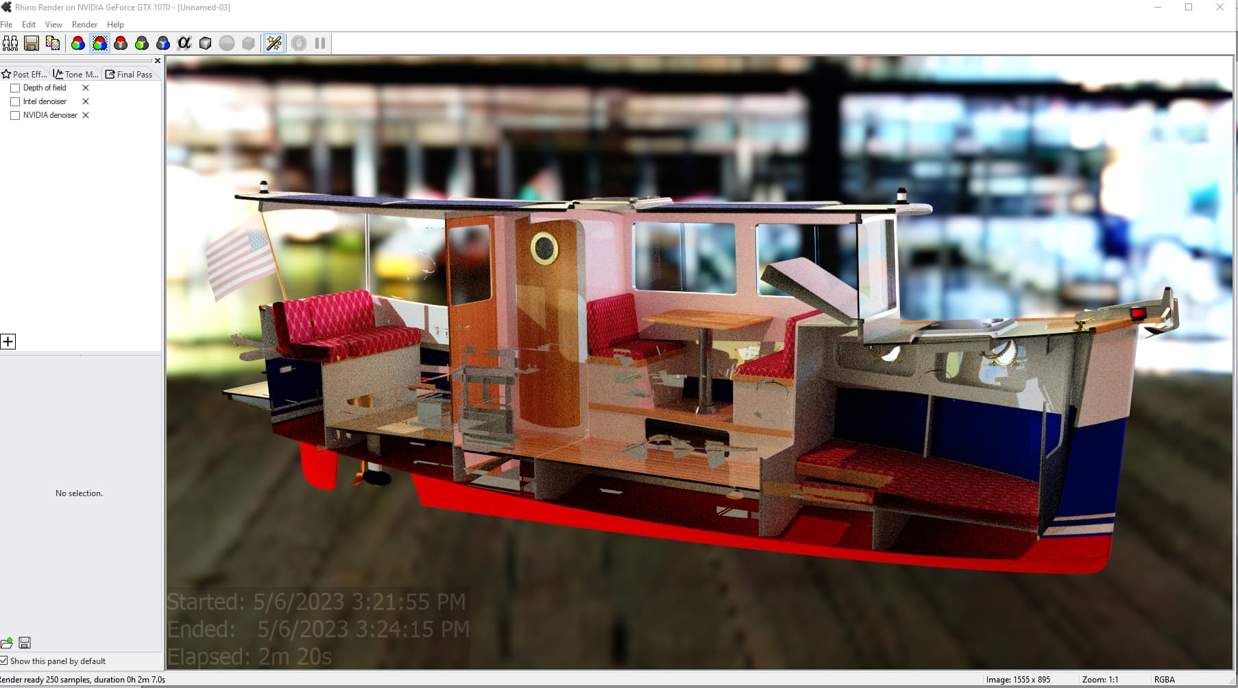

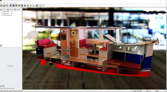

I can get the LogoViewports to work in my Rhino modeling window but what I want is to be able to see my logo in my Rhino Full render window. I am seeing a start and stop time stamp like in this screenshot but how can I change to a png of my logo?
How did the timestamp in the lower left corner of my render get generated as seen above?

@Joseph_Culbert I don’t know of any ways to add this to a render. Maybe @nathanletwory can chip in.
This could be a post effect. Either @lars or @DavidEranen can probably tell you more about how to implement one in a plug-in.
I imagine you’d have a simple GUI for controlling what information to overlay like an image for logo, or render info.
The text in bottom left corner is coming from the Watermark post effect.
One needs to register a post effect factory. The factory returns an interface which needs to be implemented. The interface allows you to modify the rendered image in the Execute function.

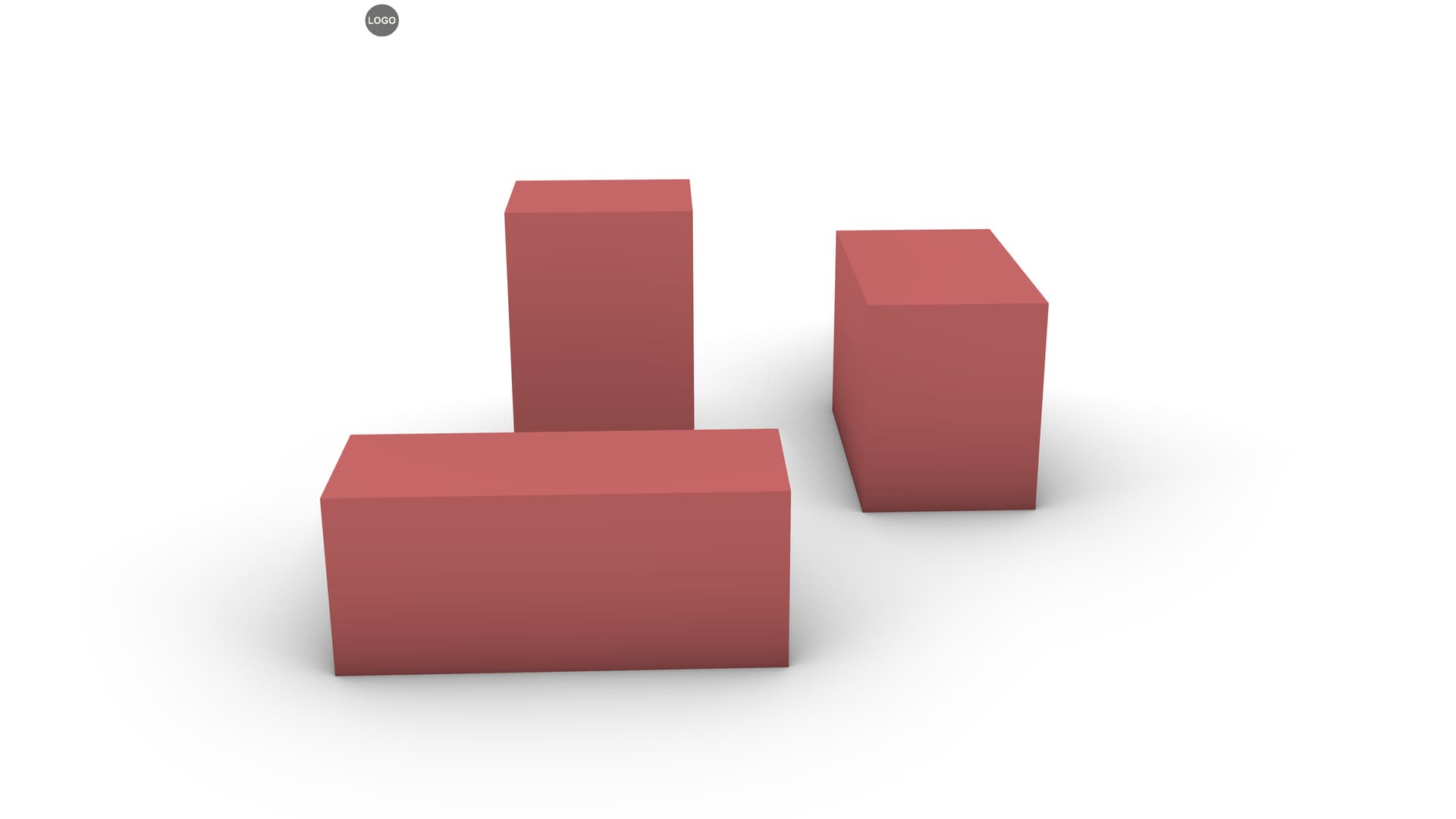

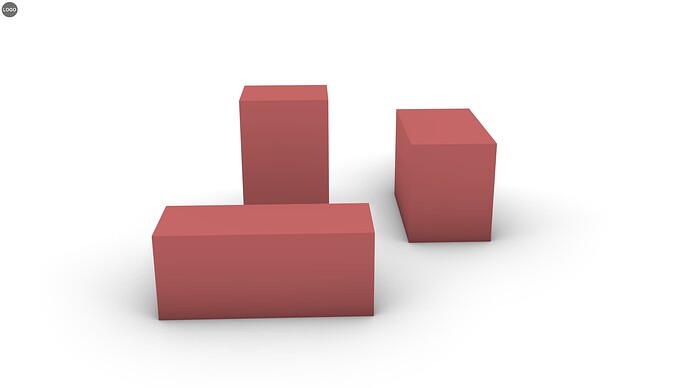

@Holo To the problems present in the actual version: When I use, for example, the “top right” position for a logo, and then I want to use “ViewCaptureToFile” with custom resolution (which does not match the viewport settings) the logo is misplaced in the captured image.
The result: (can you find the logo? :smiley: )
This won’t happen if I use the “Top Left” logo position, but the logo is off scale in both cases. I assume the top left corner serves as an anchor point for scaling custom resolutions. But then all logo placements apart from top-left would be misplaced if the resolution of an export does not match the viewports.
Yeah… This is a tool that was intended to be able to show your logo when presenting live. Not for renderings and viewcapture to files, but I see the need and I guess we should wish for McNeel to adapt this option fully. I am afraid I won’t have time to dig into the depth of working with/around viewcapture at high resoultion etc or if I am even able to do so.
