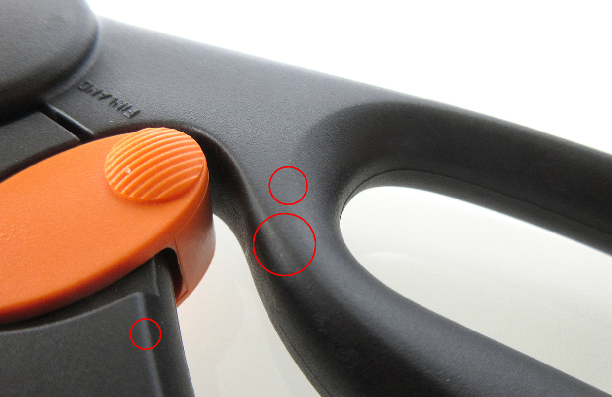

Yes, it’s excruciating. Even with simple products as the one below, when you need maybe three quality design proposals for a quality client, all G2 surfaces and fillets, draft angle, and you can’t bang this out comfortably with all the interactive control and analysis tools you need for NURBS, it’s a pain, and the engineers will have to model it all over again - and that wastes much time and, more importantly, cost.
