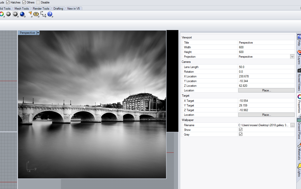

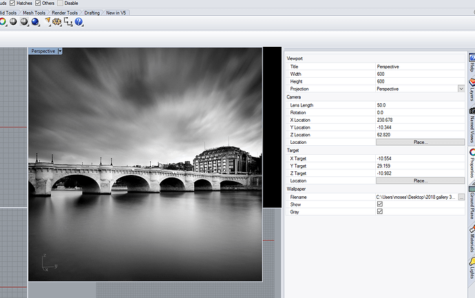

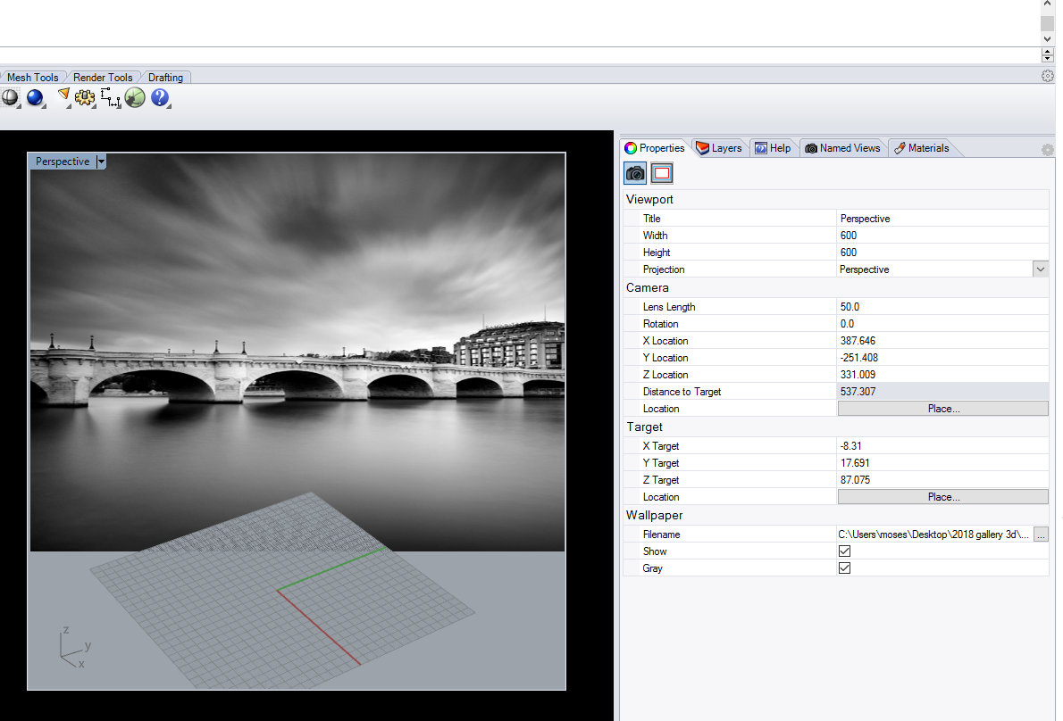

Matching perpspective viewport size (-ViewportProperties) to wallpaper image size works fine in V5. Image fills viewport completely. V6 often misses sizing viewport to image. Tried different png and jpg images.
Screenshots 600 by 600 pixel image for wallpaper
600 by 600 viewport
Rhino 5
Rhino 6
Hi Harold - thanks, I’ll check this.
https://mcneel.myjetbrains.com/youtrack/issue/RH-38070
RH-38070 is fixed in the latest WIP
