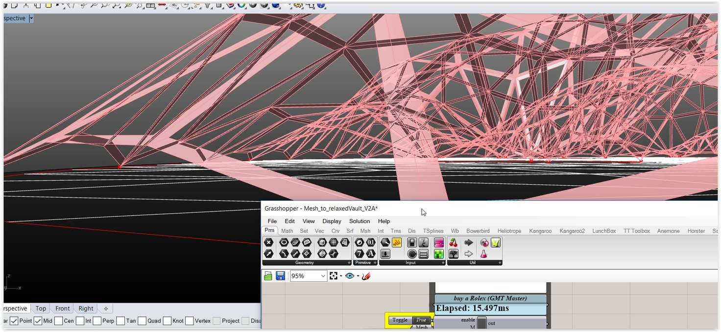

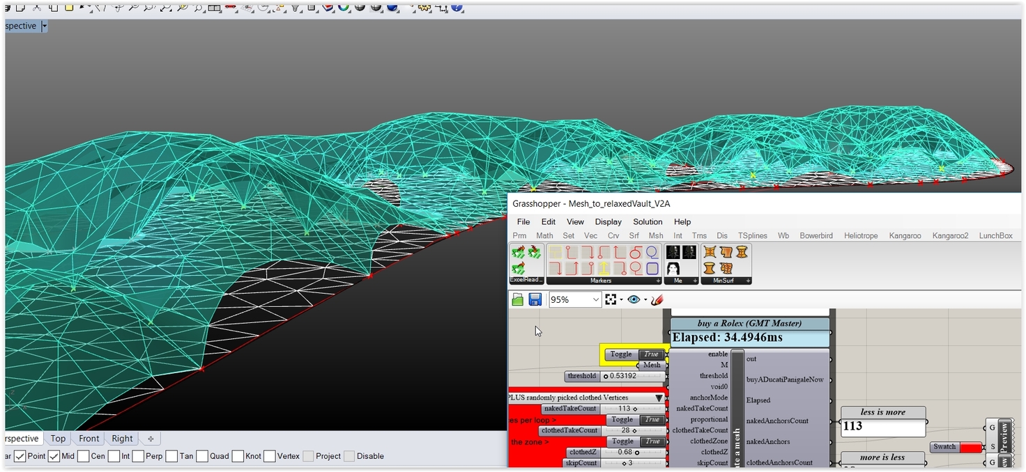

And this (I can’t post the C# for that since it flirts with reality (of some sort)) … is what K2 can do in 50 milliseconds (max):
  1. Arrange your spaces in space. Then create some sort of flat region that engulfs the footprint (any region, any N of holes etc etc). Then do some flat mesh via the MeshMachine (take care of the size of edges since it would be a critical factor later):
  1. Then mastermind an anchor points policy (many to choose: from every naked vertex to randomly selected ones either naked or clothed … OR interactively pick mesh vertices [requires code] ). Then relax the flat mesh via K2 into some sort of vault trying to engulf (by varying the K2 Goal(s) parameter values) the spaces available:
  1. Using things the likes of WB PictureFrame you can turn the mesh into some conceptual LBS system (then you’ll need to thicken that mimicking some steel members - or far better do a W truss out of the mesh [that’s the rational - by a huge margin - engineering solution for that type of things ]):
So … if your attempts with the Voronoi concept on Polysurfaces come into a halt … and your nerves are broken (for good reason) and you are running out of time (and/or espresso) … just change root and spend just a few milliseconds for any solution.
Of course planarity is not an issue … since we are dealing with triads. Why people spend so much effort and time (and lot’s of dollars) to achive higher order planarity is beyond my imagination: maybe blame that YAS Hotel.
To the trained eye things like these have a very strong reason of existence … since in some “inverse” way they are tensile membrane structures. And this virtue is what makes any AEC thingy capable to last over time.
