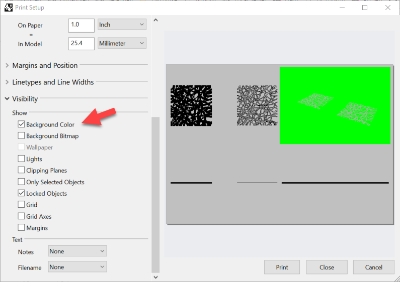

Hello - for a print, in case that helps, you can show the background color but so far not in the Rhino display when the detail is not active, as far as I can see.
THanks Pascal. THat makes it workable.
