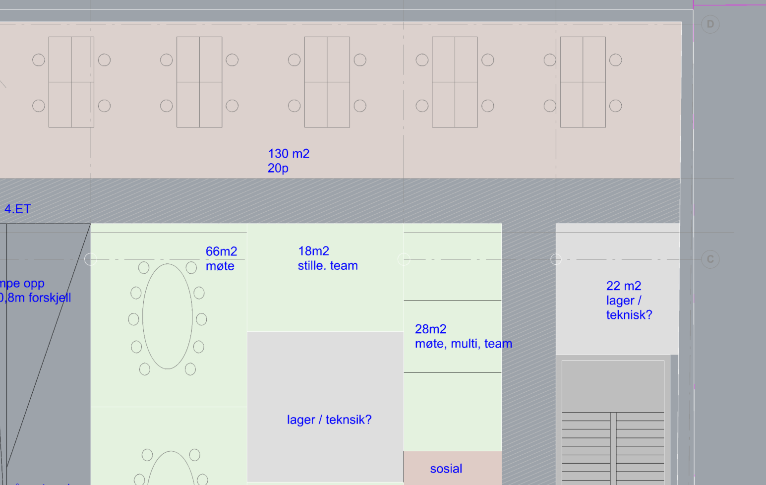

I haven’t bumped into this for a long time, but now it seems that when I want to export to pdf in vector, the hatches are on top of other linework after export. The only way to fix it is to change the draw order, but the scary thing is that print doesn’t correspond with display preview. Or are there some things that can affect this? Transparency, far from origin, other things that one might check?

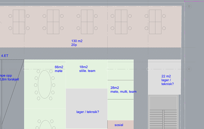

Below are two screenshots. The first one shows what I see, the second one is a snippet from a PDF. The hatches clearly cover everything else. Even though the display shows it correctly. Draw order is a fix, but the problem is that pdf export doesn’t give what I see, so it is a try-error approach.

In Layout view with PrintDisplay activated the drawing and display order is fine as far as I can tell. But when exporting the PDF, the Hatch overlays almost every line.
The layer with the grey hatch is lower than any of the other curves.
First screenshot taken from Layout Preview with PrintDisplay turned on.
Second Screenshot taken from the PDF generated by Rhino with Vector Output.
