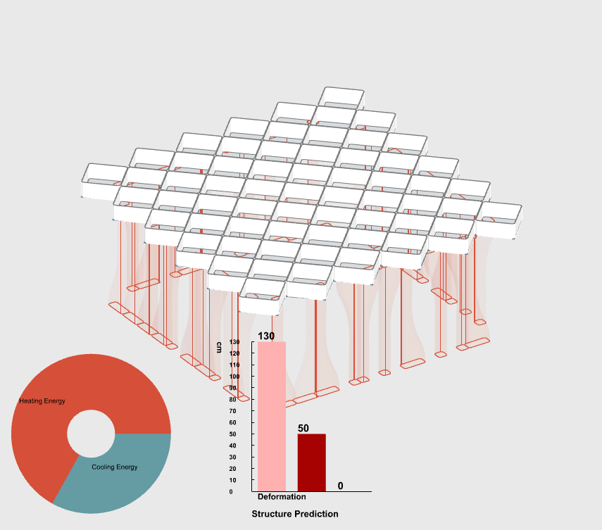

I am using a visualization plug-in called Conduit. And I want to create a bar chart with 2 values but the second value is not showing in the bar chart unless I add another value.

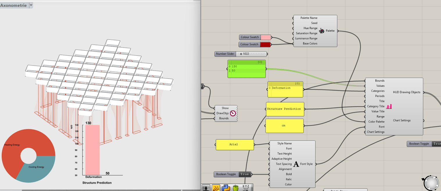

Here’s the screenshot of the script:
I would like to only have 2 bars with 2 values but if I don’t add a third value which is the 0 value, the second value with 50 will not show.
This is what it looks like if I only input 2 values (screenshot below). The 50 value will be considered as 0.
Anyone has any idea to fix this?

I don’t remember exactly how conduit works anymore, but your graph is actually fine.
The legend goes from 50 to 130, so a bar with value of 50 will be bar of height 0.
You could change the legend range with a domain input in the Range input on the bar component I think !
If not working, then please send file !
