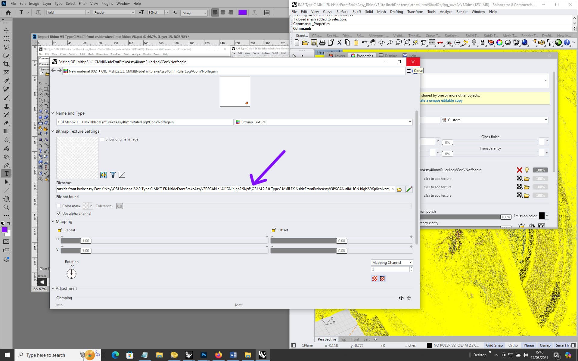

  1. import the V5 file with its three obj’s and their mapped textures.
  2. looks a mess,
  3. save the file as a V5 file.
  4. open that file, BUT STILL A MESS
  5. select the obj and look at its colour allocation, update the jpg by copy pasting in the full address taken from V5 (see image below)
  6. Rhino 8 crashes, error report appears so send details of what I was doing.
NOW IF i CANNOT EVEN ALLOCATE THE JPG TO IT AGAIN, WHAT DO I DO ?
This is serious !
Please try this exact same series of steps as you have the V5 file I sent, also the obj and its jpg.
The one I tried to update the jpg to is the lowest of the three objs in the layer palette.
the full addresss to it on my PC was
V:\Agisoft Projects overflow\Agisoft Type C Mk III nearside front brake assy East Kirkby\OBJ Mshape 2.2.0 Type C Mk III EK NsideFrontBrakeAssyV3PSCAN allALIGN high2.9Kp6\OBJ M 2.2.0 TypeC MkIII EK NsideFrontBrakeAssyV3PSCAN allALIGN high2.9Kp6colvert.jpg
and I pasted that into this window, was that the correct place to paste it ?
I try again and remove the entire jpg address as initially an obj can have nothing allocated to it (well it can in V5 !) and then one does the browse to jpg and all is good, and instead of being just the mesh , V8 CRASHES AGAIN !

this isn’t going to work. Import the OBJ into Rhino 8.
You’ll notice if you then save as Rhino 5 and Open/import into Rhino 8 it behaves as expected.

I have tried this..
1, file open the V5, mesh is good.
2. select mesh and export selected as good mesh v8
3. file new 1:1 dims small objects inches, import the V5, delete the wonky mesh.
4. file import the good mesh v8.
5. stil bad.
Damn !
try clipboard instead
2. select mesh and go edit copy, and WAIT AND WAIT. eventually its done
3. file new select template 1:1 dims small objects inches, import the V5, note location of layer and delete its layer with the wonky obj texture.
4. edit paste, and the layer reappears, move to where it lives in stack.
5. turn on layer AND ITS GOOD ! :heart_eyes:
So why does it work via clipboard and not via being export selected ?
I did try for all three layers in one copy to clipboard but had to end task V8 as it forever doing it !
So I now have an imported V5 so correct dims, then a viewable texture on the obj. in the EXACT location and scaling etc etc that it had in V5.
