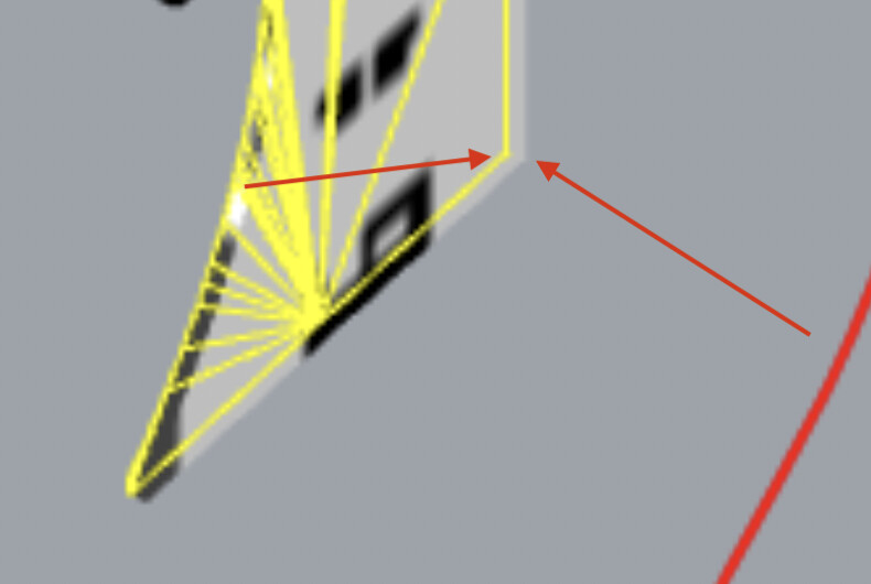

I try to unwrap closed poly surface using UV editor, but I have result shown on picture below.
Any suggestions?

If you look closely you’ll see that in the cover the inside part is selected. What you see on the outside is not the part of the texture that is selected. If you’d rotate around the wheel cover so you can see from the inside you’ll see that the texture matches.
In your own screenshot you can see you are not looking at what you think you are
The correct part for the outside of the wheel cover is elsewhere

So I guess the problem you’re highlighting here is that the round opening in the wheel cover is not round in the unwrapped mesh?
Edit: I wonder how you unwrapped this? Probably missed something while picking seams? I did a new unwrap and that gives good unwrap on the wheel covers

Between your steps 2. and 3. I clicked on the icon with the giftbox being unwrapped.

I selected all edges as seam edges. If you take some time to properly select the seams you can ensure better unwrapping with the gift box.
