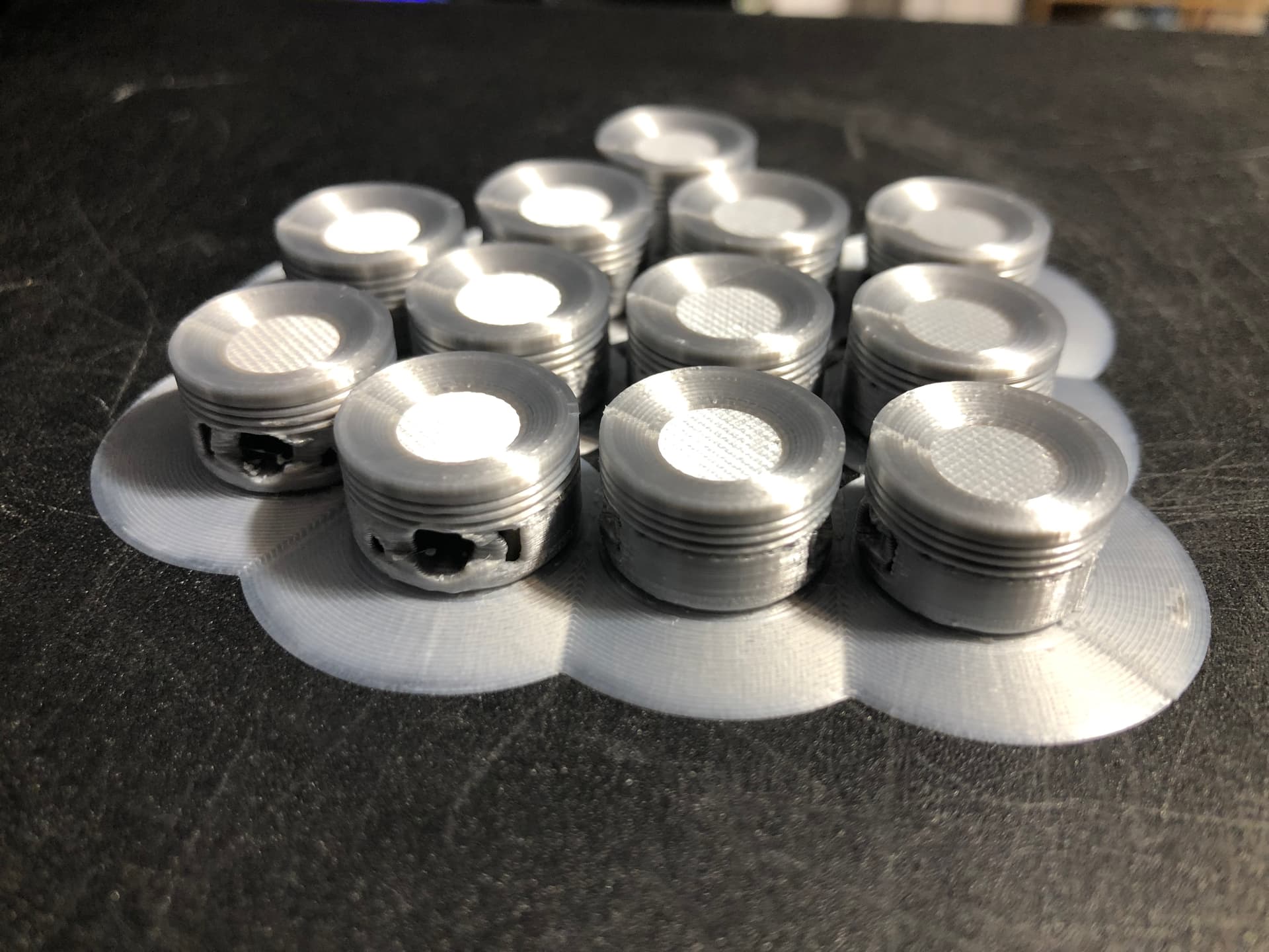

Still, I do get very good service out of Rhino. I run a 3D printer at work, a good industrial one that laser-melts nylon powder into large, strong parts. When there is unused room in a build, I add parts for my work colleagues, and for myself.
Here’s my hobby; I have most external original parts of a Rolls-Royce Merlin V-12 engine, the one that powdered the Spitfire, Hurricane, Lancaster Bomber, Mosquito and P-51 Mustang. I am also missing many of the large castings, like a complete cylinder head and cylinder block, the large heat exchanger that cools the fuel/air mixture after it’s been supercharged, carburetor, etc. Since these original parts are scorchingly expensive, and I have access to a printer, and I like 3D modeling challenges, I thought I’d try modeling these parts and printing them. So far, so good. I’ll attempt to upload a few photos of my printed parts, but as this is my first attempt on this forum, it may not work as planned. If you don’t see any images, you can see my whole album of printed parts here; rrmerlin60’s albums | Flickr
Remember, these are all modeled, quite painstakingly with Rhino (and sometimes in SpaceClaim software), corrected in a software called “Magics” by Materialise, and then printed, FULL size.
Cheers and discuss if you wish to. Tom, Ottawa.

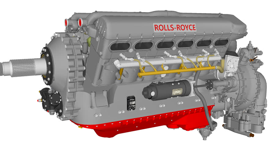

What files are you using? Would you be interested in sharing a few of your files… maybe in STL. I’m building a Merlin for a friend in england as a gift, and the cylinder heads are what i’m after. Engine mounts would also be a great thing as well.

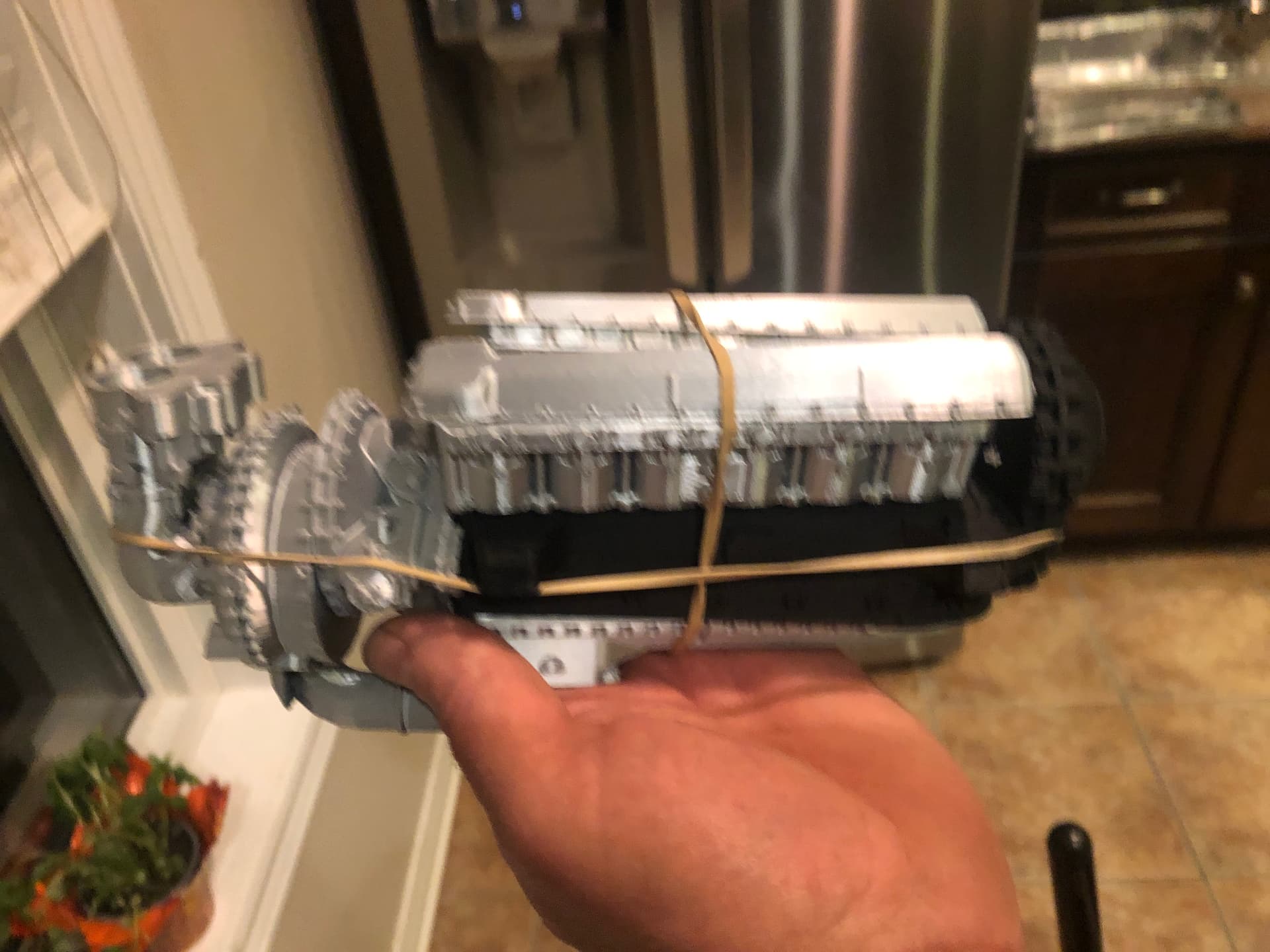

Hi Tom
Firstly, thank you for responding to my request. This engine is for a friend of mine in England… He has a passion for spitfires, and is presently collecting parts for his own collection. He hosted us (in Kettering England), And showed us around the American bomber base that my friend and I had been researching. Present day we are preparing to go to England on another history trip. We are going back to Kettering, and I would like to take Kevin a present. Our second host, is going to receive a 1/9 scale Pratt and Whitney 2800, the Merlin will go to our other friend. I’m thinking of doing it in the scale of approximately one to 10.

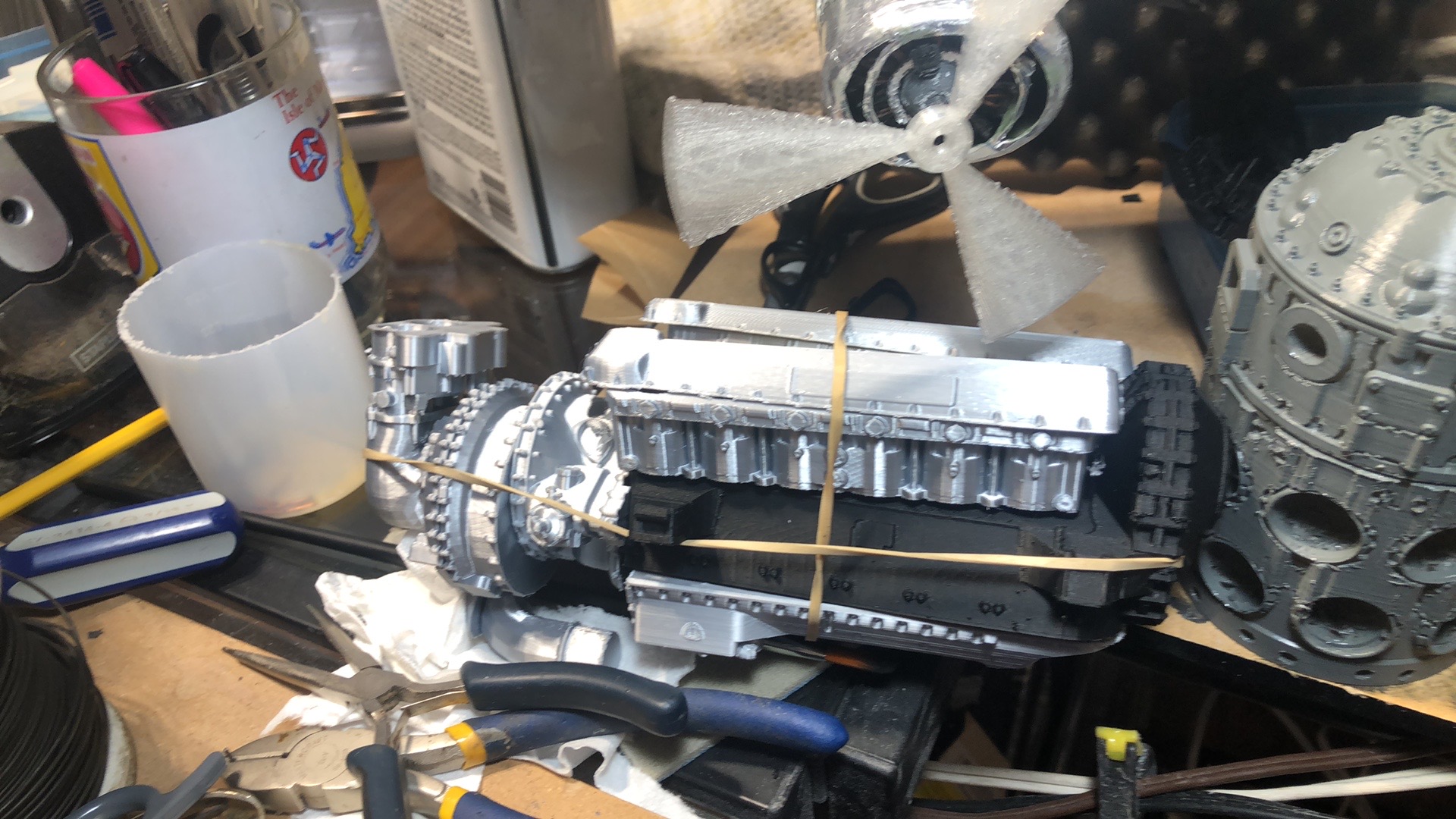

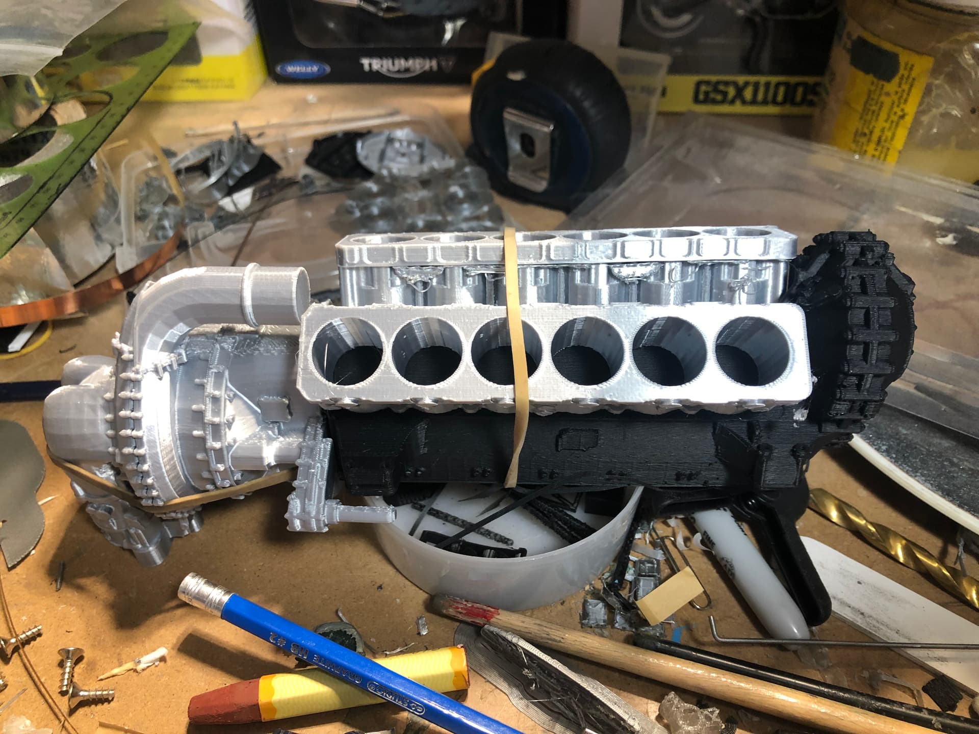

Hi Tom
I have the GA 3-D printing print of the Merlin. I’ve combined what I could get out of crab cat to put pistons into the model. But when I do that you left the cylinder head off , And the cylinder head is all supports… I thought it would look much better as a true cylinder head… Possibly with valves. My timeline is September, when we go to Grafton Underwood in Kettering. I have to say thank you so much for your magnificent work. What sparked your interest in re-creating a 3-D printed Rolls-Royce merlin.

I would like to persue some parts off of your Merlin. Ive tried to convert the files off of Grabcad… but it’s been hit, and miss. Perhaps we could persue this more privately on say e-mail, or messenger.

Ah, maybe you think that the Grab Cad model is mine. I actually didn’t upload or model that one. Someone else did. I find the Grab Cad model admirable (all Merlin efforts are admirable) but the models seem faceted and clunky. Also, it’s the single stage Merlin, and I have a 2 stage that I need parts for, so that’s what I’m focused on.

Hi Tom
I’ll have to watch the auto correct … it seems to have a mind of it’s own. That was lift off the cylinder head. … I realize that the models on Grabcad weren’t yours, and what i was trying to say was I’m not having success in file conversion from Grabcad files to STL. at minimum, the cylinder head is what i’m looking for… but in reality, the crankshaft, con rods, upper, and lower block… pretty extensive really. words are cheap, and I understand you’ve been stung… this is my hobby… I work on warbirds on the weekend…Any files you share… stay with me. What I was gently trying to say, was I would be willing to discuss, in private, compensating you for your efforts. I have the external representation of a Merlin that most people would be more than happy with…I want something special. if you decide not to share, I find that fully understandable… I can see the effort you’ve made… entirely commendable, and well done
