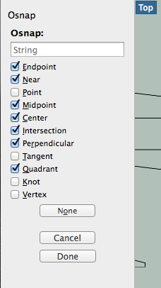

I’ve been reading this thread with interest, but I am still puzzled how it all can be made to work in my case. What I would like to achieve is the following:
I am using 5 or 6 persistent Osnaps, not including Center. On occasion, I would like to use the center snap exclusively (but not necessarily as a one shot), then return to my regular Osnaps. What would be the command macro to use as the result of typing an alias or as keystroke macro?
I have tried the “none” option that @jeff_hammond suggested, but as a result I have to reinstate all my regular Osnaps afterwards.
FWIW: I am not worried about ortho being overridden by Osnaps, but I am happy to learn about the Alt-key to disable snapping temporarily. I also managed to miss the use of the Shift-key as a temporary ortho restriction… :confused:

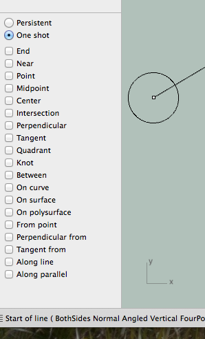

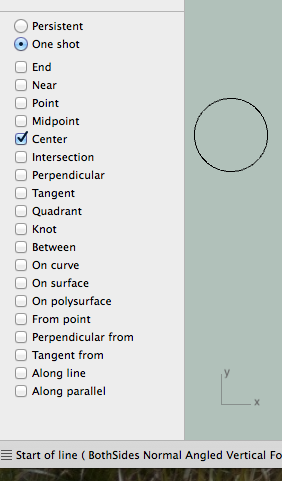

That is not what I am encountering. Typing the Osnap command brings up the options. I select the “Center” option, but that does not suppress all the other osnap options that I already selected:
I can pick the One Shot option here, which does indeed allow me to exclude everything except the center snap, but after the first snap the normal situation is restored, i.e. all the persistent snaps are available again, even though the One Shot option remains selected:
Before selecting line start:
After selecting line start:
Unfortunately, that does not function in the same way on the Mac.

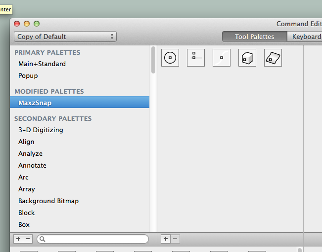

If you want to have a one-shot “Center” osnap that overrides others, use the Center osnap button from the Osnap tool palette and not from the Osnap panel. Unfortunately, Mac Rhino does not make it very convenient for you because by default you pull down a HUGE menu from that button (takes nearly my whole screen vertically here), and Alt+clicking on the button within a command doesn’t work at all to show the buttons and not a menu… Edit: actually it does work, but you do need to hold down the button for a bit longer than I expected. And of course the Osnap pallet flies out, but stays out, does not close automatically. Sigh…
Yes, another McHandicap… Sorry.
–Mitch

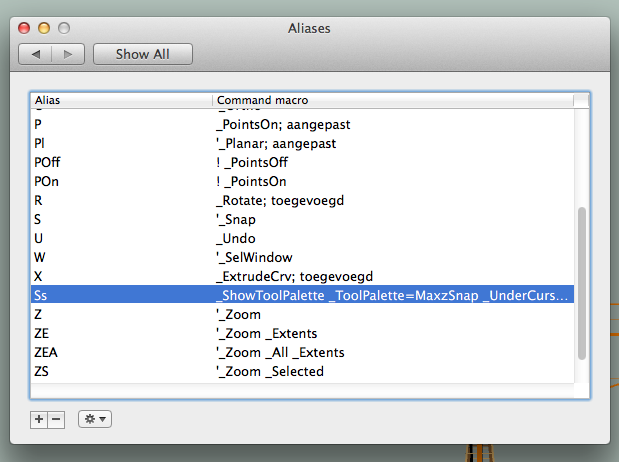

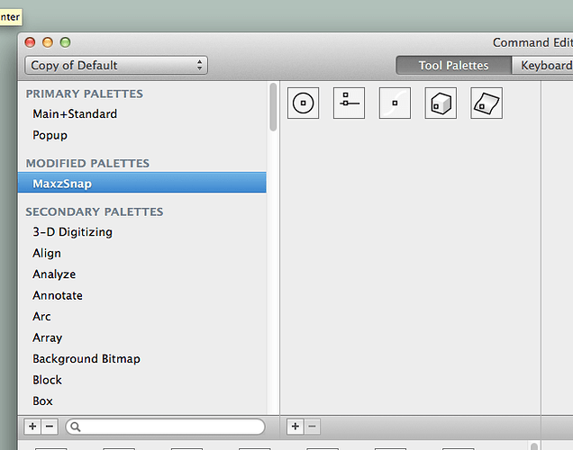

Hi Mitch, i didn’t think it was that big…
However, I did it my way… :sunglasses:
(full Alias text: _ShowToolPalette _ToolPalette=MaxzSnap _UnderCursor=YES _Enter)
Now I can open the palette I made, under the cursor, and pick an Osnap exclusively that I don’t have as persistent, without upsetting my persistent Osnaps … :grinning: Just what I wanted!

Thinking about it again… it is a bit the same as what I used before, isn’t it. When I leave the One Shot option selected, then pick an Osnap option, the same happens as I described above as my “new invention”… :blush:
But there are advantages: I don’t have to reach over to the left/bottom panel with my cursor ( I have a 27" iMac !), and I can still toggle the Project snap on/off without having to return to the Persistent Osnaps first.
