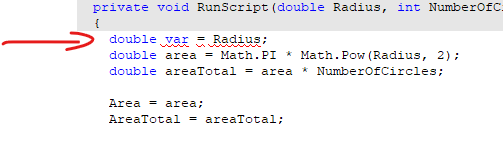

A good start is to avoid using C# keywords as variable names (“var” is a C# keyword, hence the red underline markers). And even a valid variable name must be used in the rest of the code to have any effect.

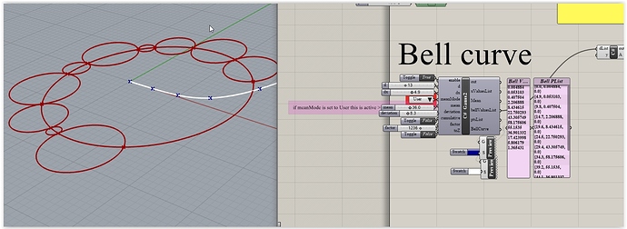

CirclesOnGrid_EntryLevel_V1.gh (125.7 KB)
Notify if you are brave enouph to dive into the abyss for doing this properly for the general case (clustering, any query, classes, cats, dogs etc etc).
EVERYTHING LOOKS GREAT!!! oh my God!!! BUT as I told you the radius of the circles shouldn’t change you know the radius of the circles should be the same! I think what they ask in the exercise it is something more simple. A simpler version of this. cause we just started programming you know. Man please how did you do that … I don’t know! Can you give me your email ? Do you offer online tutorials etc??
My dear Watson: If they are steady why bother talking?
Anyway … since you support Lewis (and Valentino I do hope) you’ll get extra stuff.
CirclesOnGrid_EntryLevel_V1A.gh (126.7 KB)
