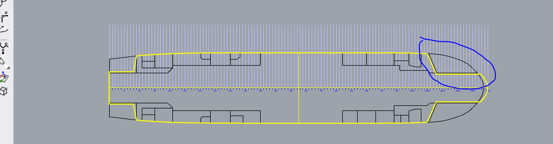

I have a surface that has a few trimmed sides. When I untrim one side of the surface, the whole surface gets untrimmed on all sides. How can I untrim only one side of the surface?
For Example, I would like to untrim only one edge in the following picture.
If the trim represents the outer border of a surface, Untrim will naturally remove the entire outer loop to get the untrimmed surface.
If you want to modify a specific area on the outer border, you might try ReplaceEdge - check the Help for options.
