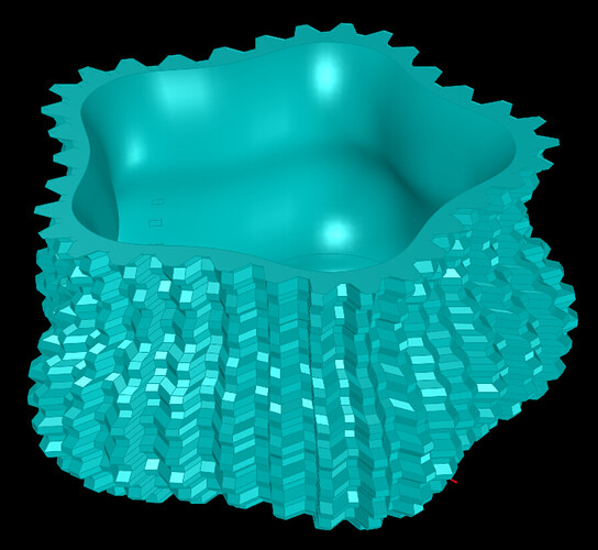

Thanks inno - it never would have occurred to me to locate sweep curves the way you did. I tweaked the curve a bit and added some stuff to make an inside surface. It ends up as a nice Closed Brep:
There are still a few tweaks left to do, but your method works fast, calculates and renders quickly, and is much simpler than what I have now.

Yes, RailRevolution works just like I thought Sweep1 would work. (I’ll leave it to the McNeel gurus to figure out why it doesn’t) But clearly it does not. By using RailRev the whole process becomes much simpler. It also offers the benefit of not requiring a circular cross section, which means I’ll be able to use Rail shapes like this:
which results in this:
