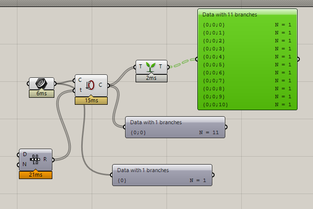

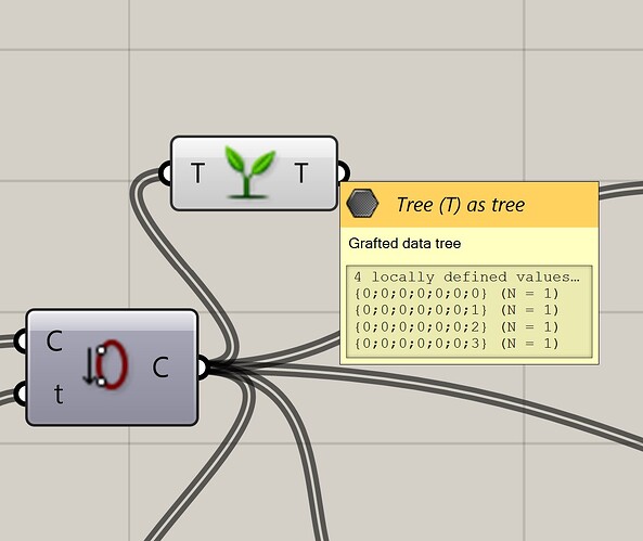

I could have sworn that in the past, if I grafted a simple list, I got {0;0}, {0,1}…etc, regardless of how deep into my definition the component outputting that list was.

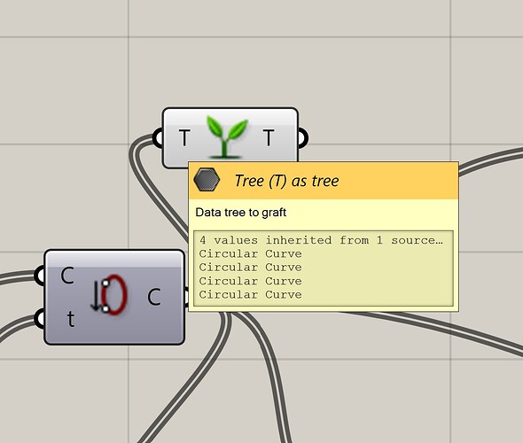

But I’m getting this:
From grafting this:
The seam component has a bunch of other stuff before it. Am I nuts? Has this always been the expected result? Or did I change a preference or add a weird plugin that’s changing GH’s behavior?

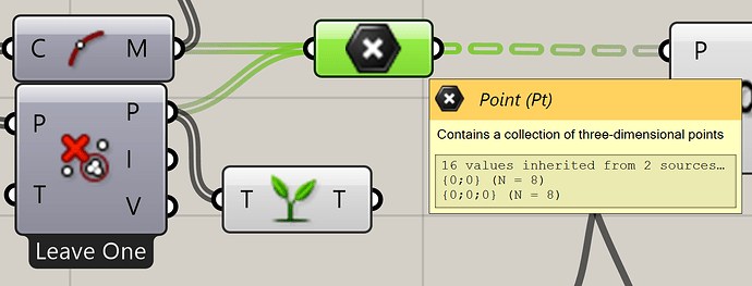

Also, here two simple lists, connected to point container, become two different trees of different length. Is this normal?
Can you send a sample?
I’m seeing this in both Rhino 7 and the WIP, which seems normal to me:
This is the standard behaviour, even though data is stored in a list it still has a path that is not necessarily {0}. Especially if you have a lot of components in a row.
There are workarounds… (flatten everything - usually a bad idea ; Trim Tree or Shift Paths - robust, but tedious ; Suirify - still tedious ; Smart Merge - my own solution to these tree structure problems).
