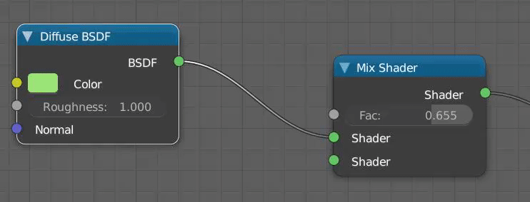

Node Wrangler for Blender has quite a few cool Node-Rewiring features. Not all of them are applicable to GH but maybe you find this interesting nonetheless.
Already Blender’s default wires auto-connect with the most plausible Inputs/Outputs when dragging an empty node over an existing wire. I find myself regularly in the situation where an existing definition still needs a bit of refinement upstream (reverse vector, divisions etc.). Here auto-wiring may save a lot of clicks.
I also like how Node Wrangler lets you swap an existing node for another one (turn an addition to a subtraction). Obviously all this can also be dangerous, but one can also wire stuff manually which lets Rhino freeze :o).
Cutting wires (hold Ctrl while dragging over wire)
Wire Auto-Connect. One may even delete the new Node again and the wires reconnect.
