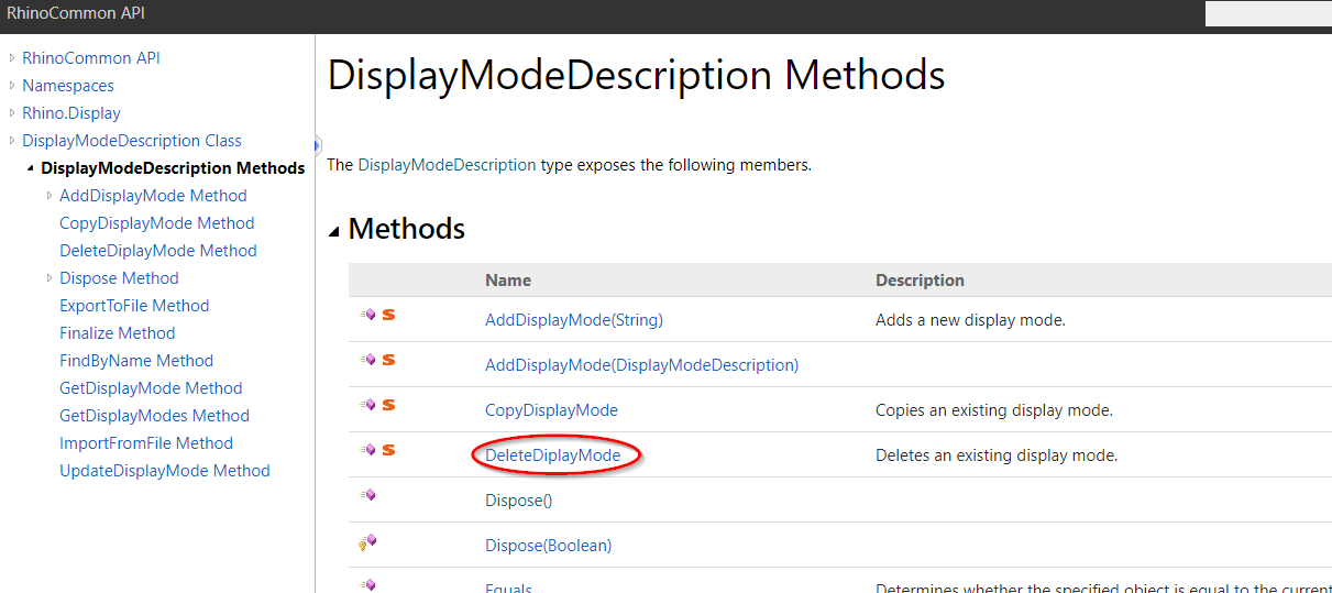

Typo in in Rhino.Display.DisplayModeDescription.DeleteDiplayMode
Hi Willem - good catch.
It actually works with the typo. I guess fixing it now could potentially mess up any code written to-date :slight_smile:
Caught it while trying to find a solution to your issue in the other topic.
I guess there will be a need to keep this typo method working and implement a copy of the method with the correct naming. But the developers will know how to solve this best.
