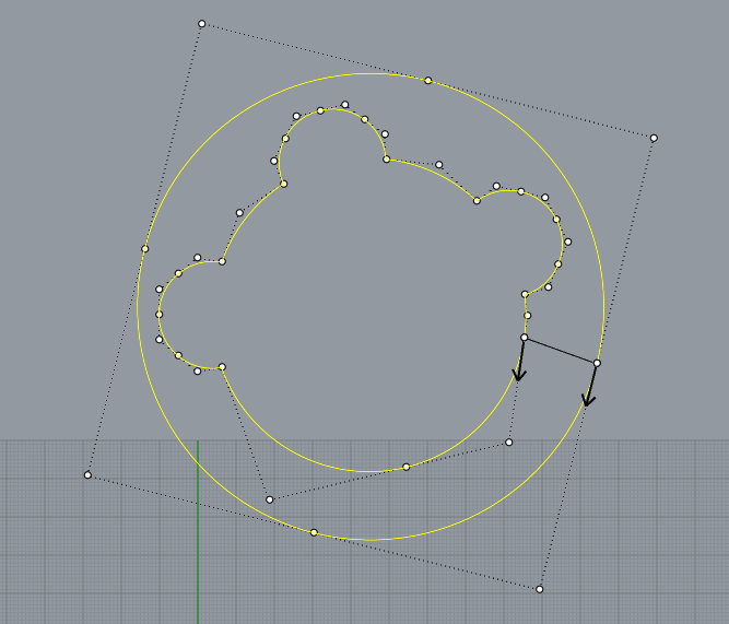

expecting this get:
Hello, Could you upload 3dm files?
Untitled.3dm (52.0 KB)
The [CrvSeam] command allows you to adjust the Seam position and curve direction for each curve. After adjustment, execute the [TweenCurves] command.
