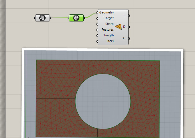

Not sure how to word this right, but I suppose this will do. I’m trying to circle pack a shape with an opening inside, but triremesh meshes over this opening.
In the picture, the greenlit edges show the boundaries of the shape.
How do I fix this?

For trimmed surfaces you need to pass them as Breps.
