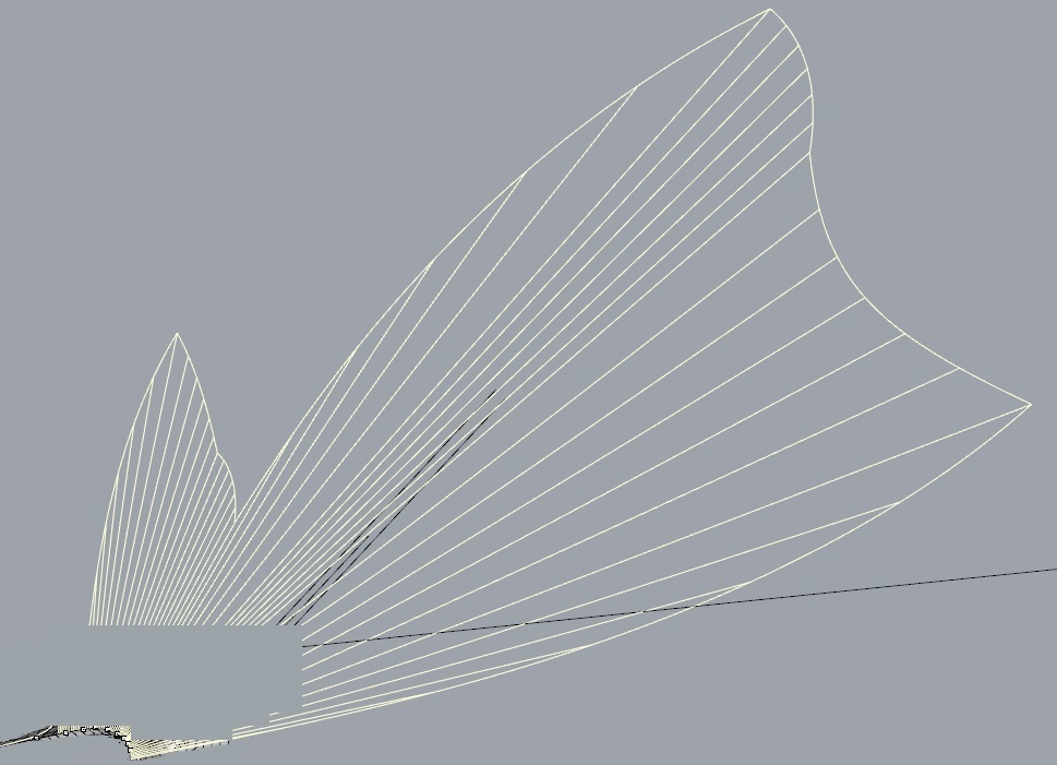

When I first started to learn Rhino more seriously (a few month ago) the CurvatureGraphs always looked so smooth, even when curves were visibly “bumpy”. The graph remained relatively smooth (rounded outer edges) even when I adjusted it in different ways as to show meaningful resolutions, aso.
But recently I started to see only very “thorny” graphs. It doesn’t seem to matter how I go about trying to smooth the curves out, the graphs are still thorny, spiky and disrupted.
The curves in the picture has degree 3, geometry irrelevant (not my model) just illustrating the “thorny” & spikyness).
So my question is:
Q: What is the typical cause for curvature graphs being “thorny” rather than having smooth transitions even when curves are obviously bumpy? Settings, or manipulations of the curves forcing them to become “thorny”, or something else?
// Rolf
Hi Rolf - hard corners in the graph are discontinuities in the rate of change of curvature. Graphs like the one you show are often from more complex curves, such as projected curves, or trimmed edge curves or refit curves . My guess is that this curve is quite dense - in many cases the shape can be drawn with a simpler curve, but of course, not always…
Keep in mind that the scale matters - even small g3 discontinuities can be blown up to look dramatic with a high enough scale on the graph.

Then I understand why my curves became thorny (have to make complex support geometries in order to derive my final curves, often ending up with slight rate change" discontinuities.
Is there any simple fix for the “rate change” discontinuities? I’ve tried like FitCrv etc, but to no significant avail.

Hi Rolf, I think this depends on the degree of the curve. Curves with degree 2 don’t have curvature continuity, so the curvature graph will break, higher degree numbers like 3 or 5 should give a better continuity in curvature. What degree is your curve? What happens if you run ChangeDegree command with deformable set to yes and put a higher number?

I have tried just that (changing the degree, to 3 or 5), but that doesn’t help. As pascal pointed out, the structure is disrupted somehow (the distribution or distance between between the ControlPoints?).

I wonder if it isn’t down to the curves being multispan? Try using only single spans and see what the difference is. This is of course much more work…
Yes, multispan is often the case, due to the need to have cuts where to attach perpendicular curves, then joining again, and then the “thorns” will disclose something about the history behind that curve…
