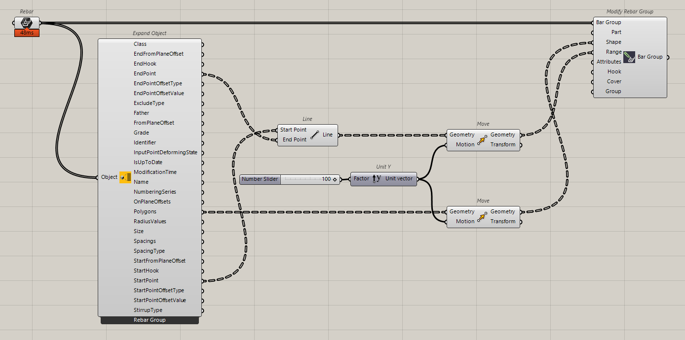

Any hint how to move/ copy a rebar group from XY coordinated to another?
Aim is to copy local concrete elements from local to global coordinates including their rebars.
I managed to copy geometries using modify beam but not reinforcement groups
Move tekla geometries.gh (30.0 KB)

If you want to do this using existing components, here’s one option:
Note that there shouldn’t be any grafting for the Shape input.
You’d replace the Move components with whatever transformation you want to do to your curves of course.
