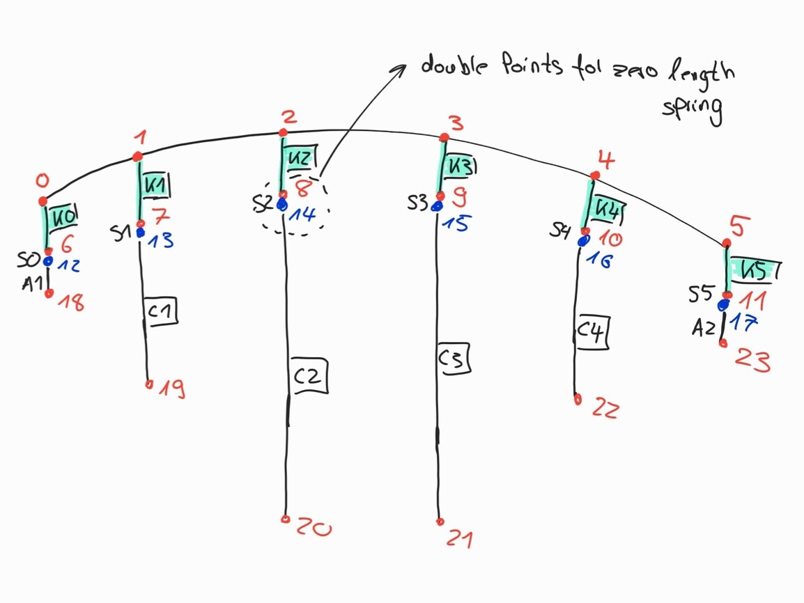

I have a bridge model where I have difficulties with bearing. The bridge has 5 fields. The two middle pillars are fixed pillars (translation in x,y and z locked). The two outer pillars allow a movement of the superstructure in the x-direction. At the abutments the bridge is also movable in the x-direction.
Between the superstructure and the pillar are rigid coupling rods. Between the coupling rods and the pillars are springs with a zero length. Same principal at the abutuments with shorter rigid rods.

I have prepared the model more comprehensibly and in the following picture the knot numbers are shown:
Tangential bearing_1.gh (90.8 KB)

Hi Clemens,
I was able to find a solution by increasing the spring length to a minimum (1cm). As a result, the springs have aligned correctly.
