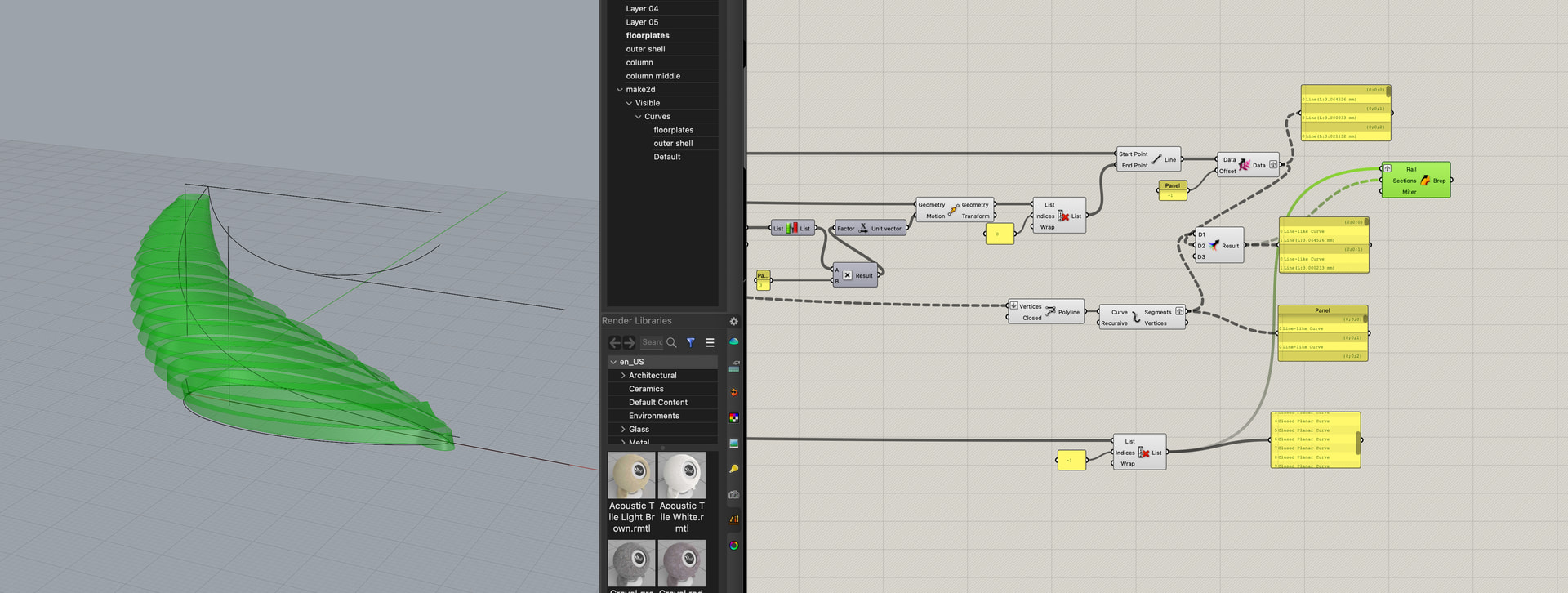

I am trying to sweep two merged sections across these eliptical shapes and its not return a smooth sweep.

Well…I’ll mention not all your sweep sections intersect your rails ![]()

*As workaround, I’ve ‘forced’ your elliptical rails to make contact with your sections, plus a tweak to accommodate for Sweep2 instead.

is there any way to make it conform more to my previous rails? because this solution creates a large offset from the original ellipsis that I was trying to sweep across
I believe so, one way* below, with bad results ![]()
homework 3-conform-lines.gh (95.7 KB)
*‘Snapping’ your non-touching sections (line pairs) to their corresponding rails (ellipses) isn’t a big hassle, the problem is that Sweep1 is still grasshopper sweep, and it does whatever it wants!
Also, my ignorance impedes a better explanation, I apologize. However, I can tell you that the errors in the grasshopper sweep result do not occur when I bake the ‘conformed’ lines and perform the sweep manually in Rhino. In fact, the sweep that got skipped (bottom) does work without a problem manually. This just leaves us with more questions ![]()
