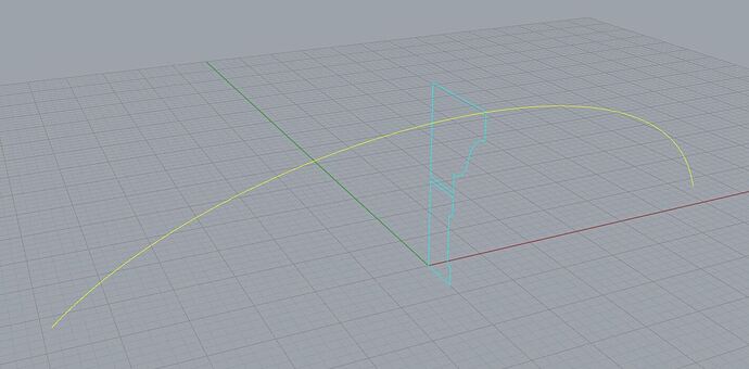

Hello. I am looking for some guidance as to how to sweep the two shapes shown in the image along the compound curve shown. These shapes form an arch wrapped on a cylinder. I am very new to Rhino and I cannot get it to sweep correctly. Any help would be most appreciated!
Thanks!

Hi Tom - is this it:
Compound Curve_Maybe.3dm (1.3 MB)
Sweep1, from relocated profiles (rotated in Front) with 'Roadlike on the axis shown.
Actually, @Tom_Haws - I take that back - Freeform Sweep1 may be better here, not Roadlike.
File is updated
Yeah, that is what I got too. From the top it needs to look like the attached image. The back face of the profiles need to stay vertical - no rotating back and the back face needs to cut back perpendicular to the front face at the ends.

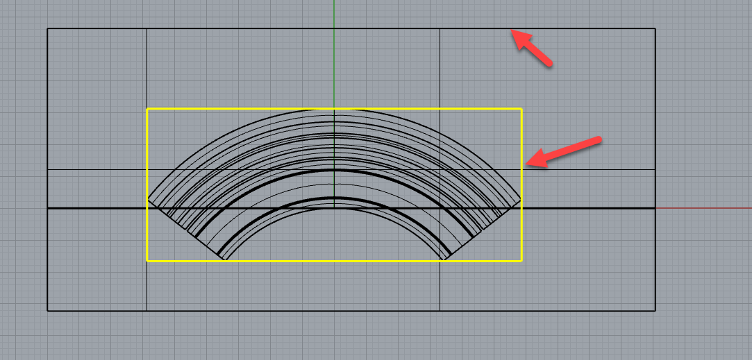

Both your top and lower profiles are tapering out away from the cylinder. If you look at the bottom view, you can see that clearly. The intent is for them to ā€œhugā€ the cylinder. The back side of each profile should be flush.

I keep getting this error:
Yep - the target cylinder surface needs to be big enough that the biounding box of the objects hits it completely - in the example I posted the cylinder is big enough.
