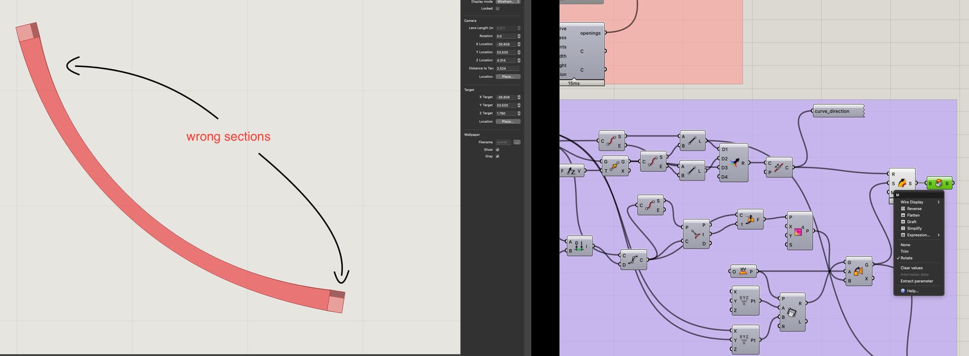

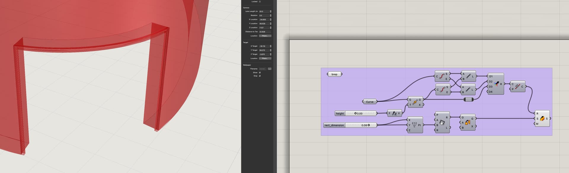

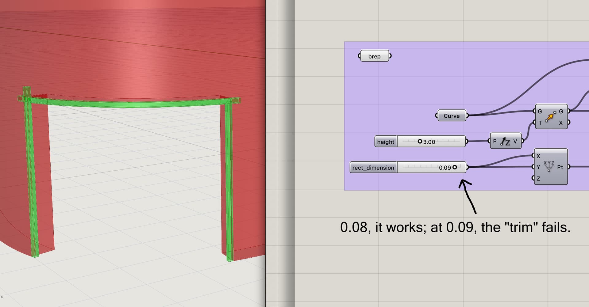

Can someone explain why the sweep cannot trim more when the rectangle’s dimensions are more significant than 0.08 (8 cm)?
I’m going crazy to solve it.
sweepone_issue.gh (47.9 KB)

It doesn’t work if the rectangle is BIGGER then 0.08, not SMALLER. At 0.04 it works here too.

If you set it to None and then you Join the result, you may get something similar to what you are looking for. But yes, I am getting the same result as you with the Sweep1.
If I try to do it manually in Rhino, I can get the result by choosing Untrimmed miters, but I do not see that option in Grasshopper. But you will still get some problems in the faces.
Also, I think the potential reason for Sweep1 not working the way you want is because of a tolerance issue. The two vertical sweeps have orthogonal faces, but the upper one has two curved faces, so trimming creates problems. It is never going to be possible to have three coplanar faces in the front and the back. When the side of the cross section is small, the trimming is easier than when it is larger.

oh, sorry for misunderstanding. There’s a geometric impossibility for that sweep to work.

Hi @lopez,
How about this?
SweepSegmented.gh (8.1 KB)
