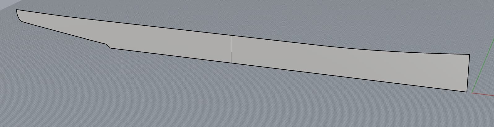

In the attached I have a surface that does not render. No matter the display mode, it shows up wireframe.
Problem Surface.3dm.zip (110.1 KB)
The trim curve is a mess.
_UntrimAll surface keeping trim objects. _Explode curve and check _Dir.
kuva
Zooming in on the area shows many tiny curves in opposing directions
and other unclean parts after removing the tiny curve mess
kuva
Once cleaned up and joined together it’ll trim properly
