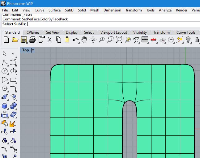

SubD to Nurbs - clean surface?
Sure, here is one:
This does not change the geometry of the underlying surface, so edges (or what would be an egde if the faces were unpacked) will stay the same as with unpacked faces. However, it will be easier to keep the surface smooth as you further edit it, given that whenever possible merging faces reduces the CV count. This thread has a dramatic example of how much that can simplify the CV hull.

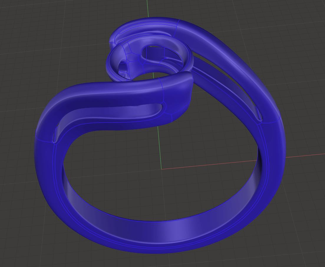

In this example packing didn’t work @27400 subD faces.
[it is not that this particular mesh geometry needs such high subD face count, but were I to have add some ornamentation as I usually do… high face count would have been necessary ]
Here with 17500 faces it worked well.
thanks a lot

While I understand the counting of CVs. I find the the number of Nurbs surfaces is critical in trying to transfer these models to engineering programs. The reduction in the number of surfaces here can be staggering.
