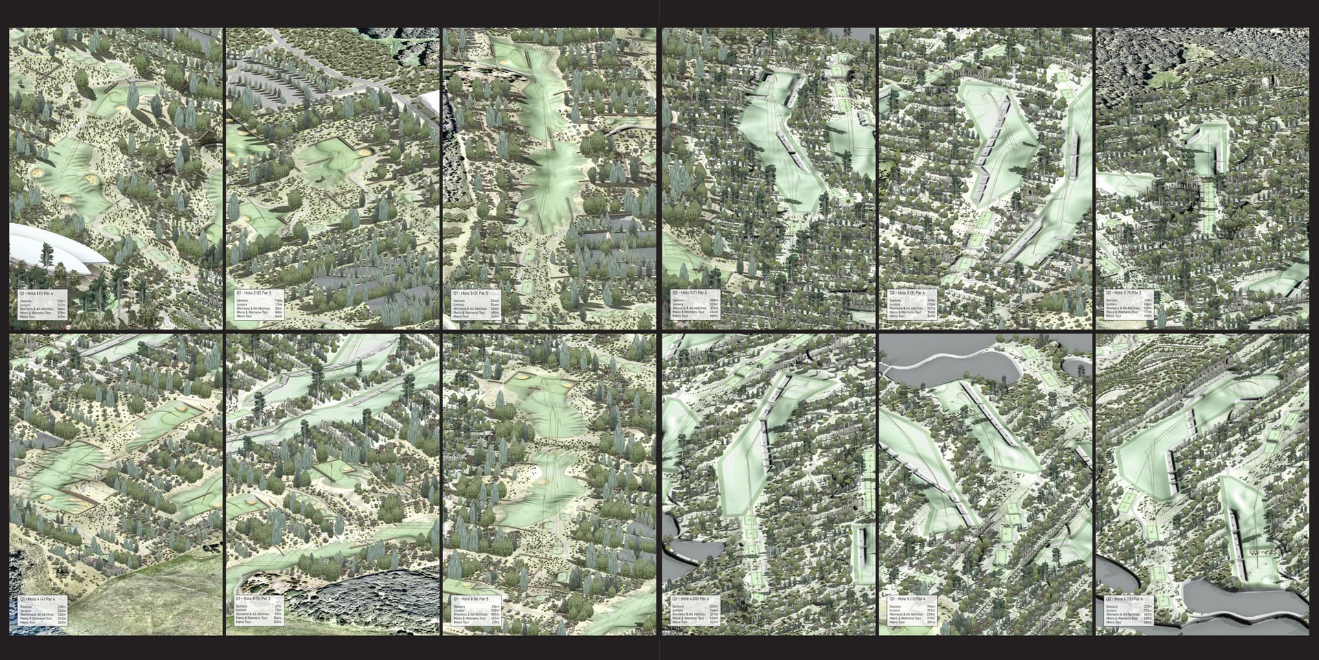

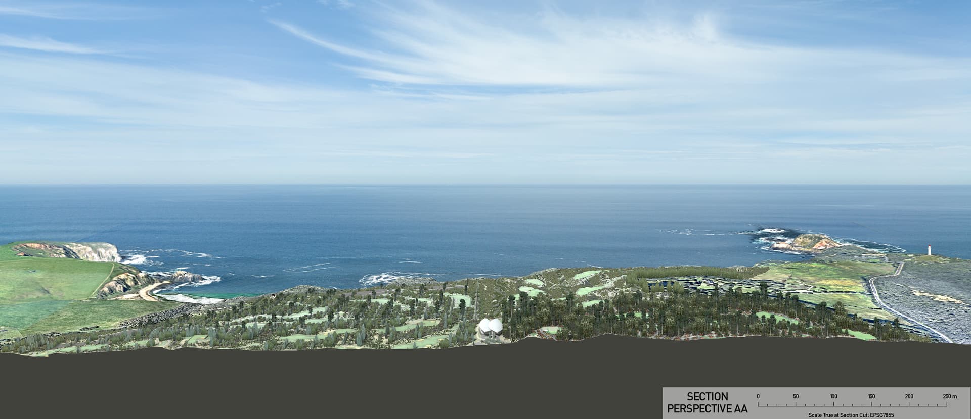

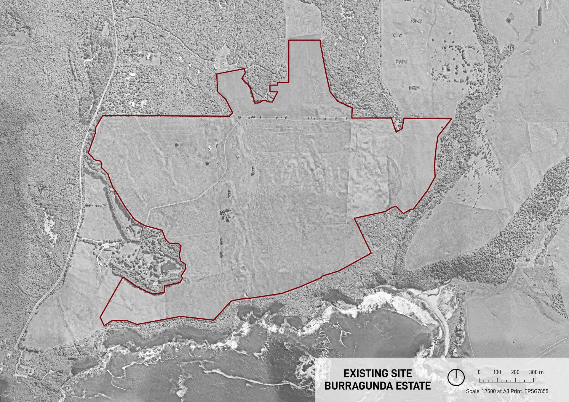

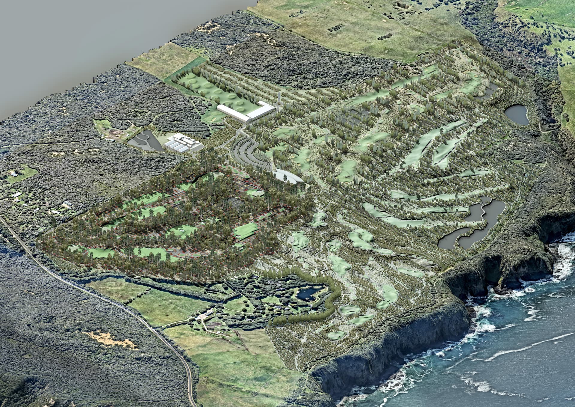

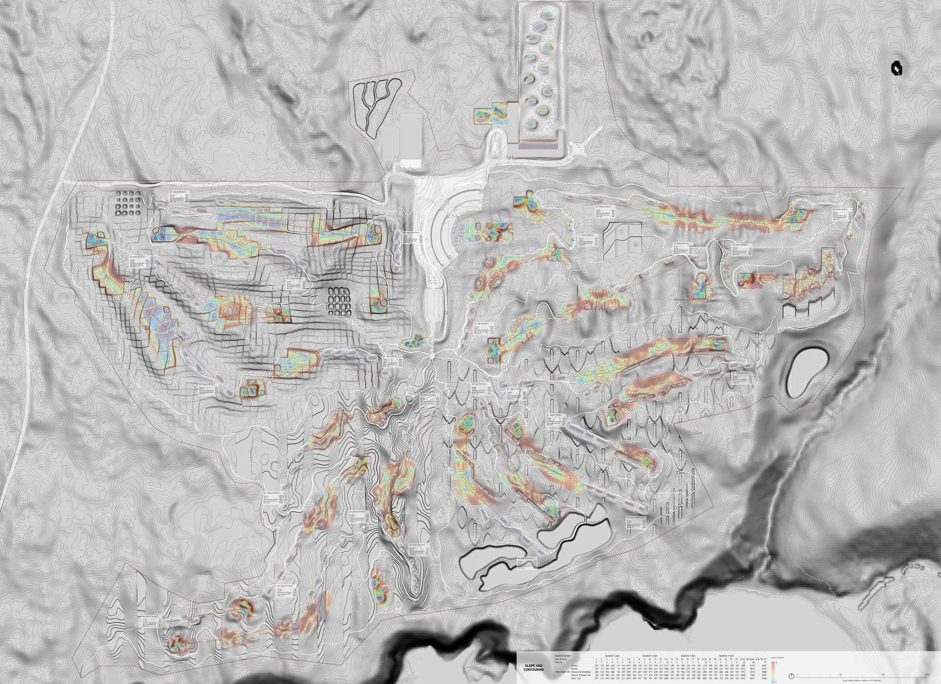

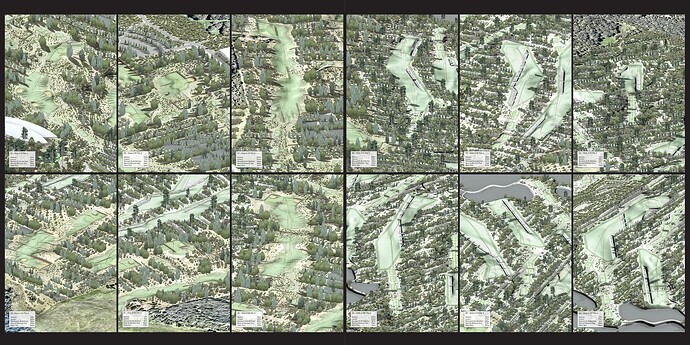

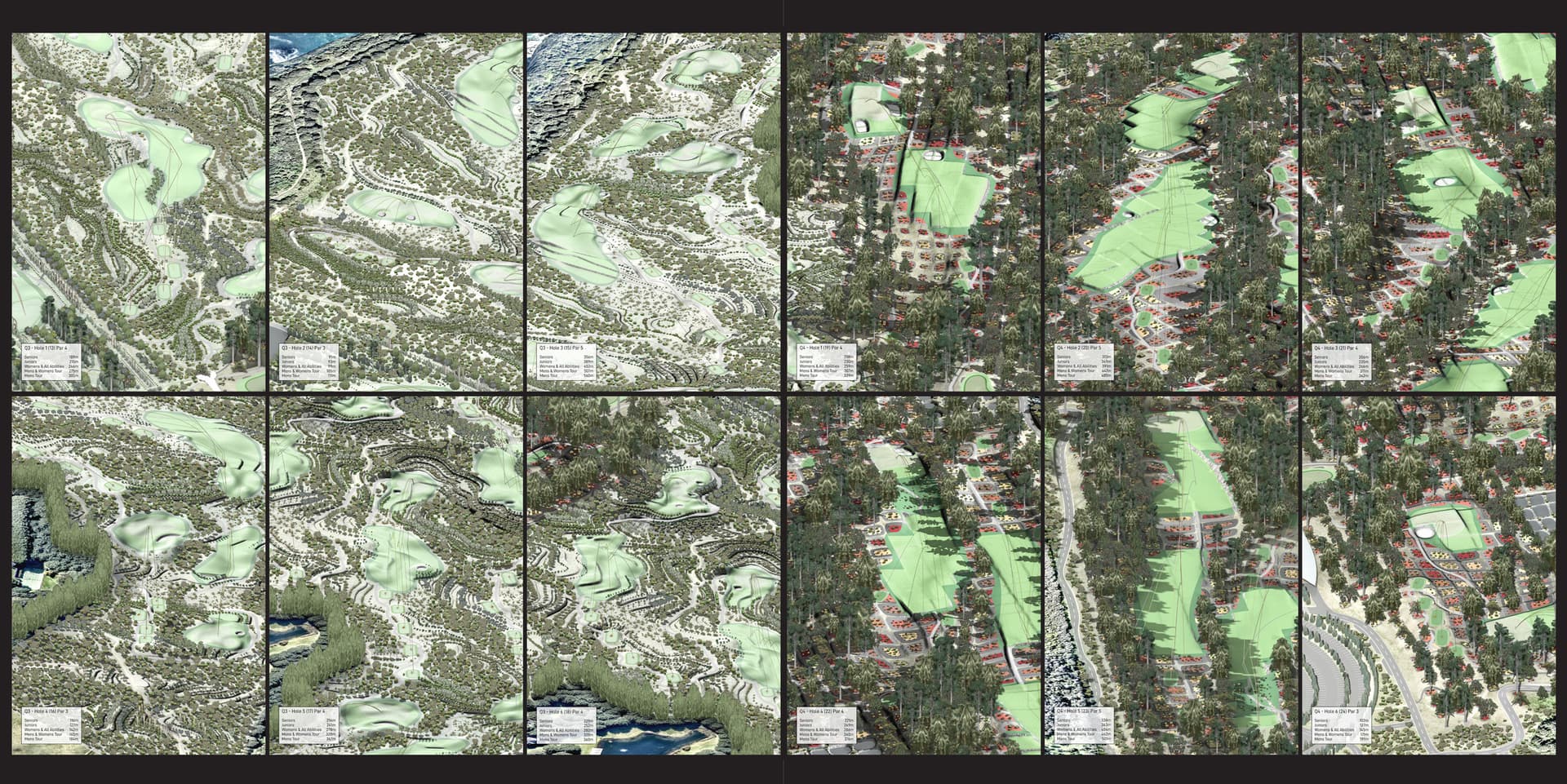

Hi there,
Just wanted to share this landscape architecture thesis project which I pursued this semester. It was made using Rhino, grasshopper/heron, photoshop, and QGIS. There was no real workflow precedent, so I just tried my best. Made a mesh from contours, made colour from hatches into a jpg, projected that as a material to the mesh, added hand painted pngs to that surface as trees using project grips/random rotate/random scale, rendered the frames out using Horster in GH, and compiled the sequences for videos.
Two videos
The thesis: https://www.youtube.com/watch?v=eKjcbpDPeUY
Design of 24 golf holes: https://www.youtube.com/watch?v=ShCph4xAcqk

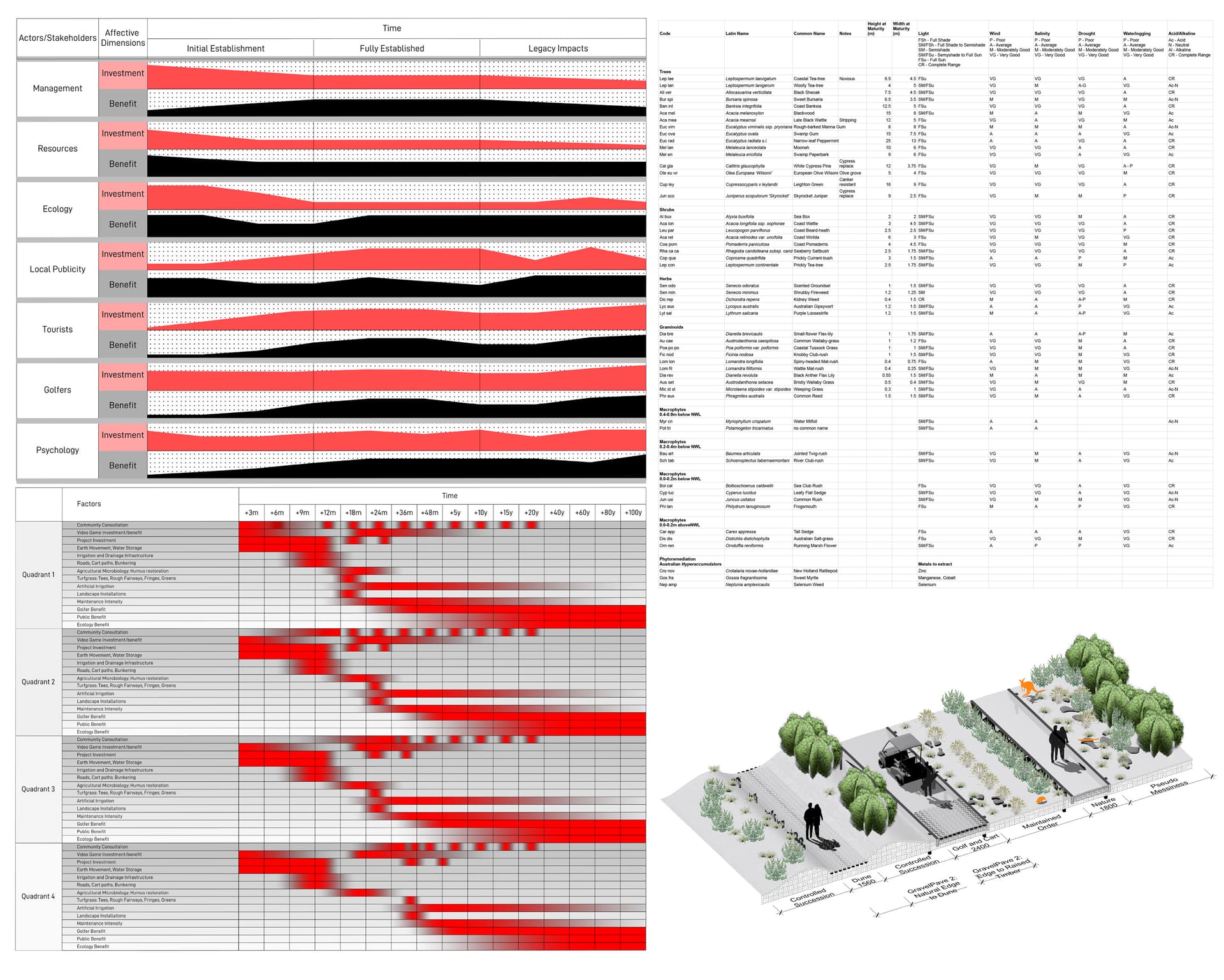

Panels:
I hope you enjoy
Jeremy
