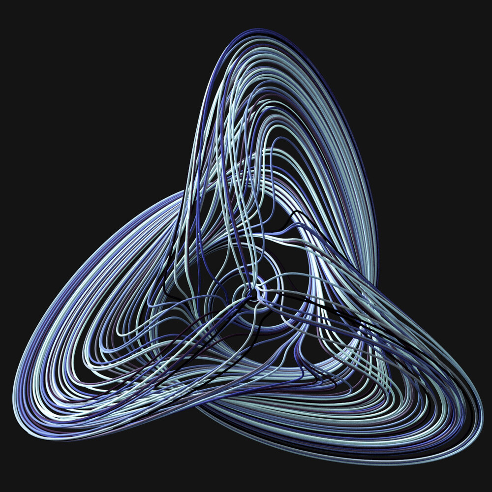

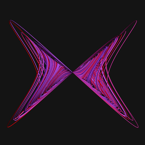

I have started a ‘Strange Attractor’ series and I wanted to share some images with you guys.

Can you please share the gradient map you are using by the Dadras-Momeni attractor? Thank you.

Im impressed at the visual quality of the lines.
Did you make tubes to render or are they colored lines with gradients?

Thank you! They are really simply in practice. Just a bunch of 3 equations to compute the (x,y,z) coordinates of each point. Then interpolate.
They are mesh tubes, made from an interpolated curve. I imported the curve into Blender to make a pipe out of it because Rhino just could not manage to do it fast enough. I then imported the resulting mesh into Rhino again and colored using Grasshopper with the ‘Gradient’ and Mesh Colours’ components following the original curve as an axis for the color gradient. The material is the generic one from Vray with the diffuse being the vertex colors of the mesh.
I have to say, beautiful job on the Chimpanzee plug-in Matouš! Although I did not use it to create these, it has definitely been an inspiration. It has also been very useful as some sort of library. Oddly enough there aren’t complete lists of attractors on the internet.
I actually coded these myself as an exercise. Although once I nailed the first one, it then was a matter of replacing the formulae so not that much learning after the first. This the C# code for the Dadras Attractor.

You mean this?
Here you go!
gradient_01.gh (14.5 KB)
@ramsena Thank you for the gradient map.
