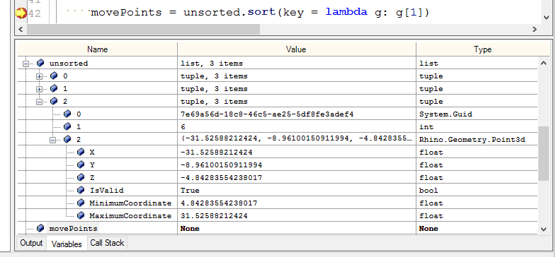

Hi Willem,
I also need sorting a window selection, but unsorted.Sort(...) only returns a empty result (movePoints).
unsorted seems to be fully valid before attempting to sort it (and it runs three rounds in the Sort function). How can this be?
Any hints about why it fails?
// Rolf
Hi Rolf.
Note how in my example the list was sorted in place the list itself was changed and no result was expected.
You assumed the .sort method to return a sorted list yet what happened is that the list ā€œunsortedā€ got sorted.
You could use however
movePoints = sorted (unsorted, key = lambda g : g[1])
Some more on sorting in python
-Willem
#sort
OK, I found the error, sort of.
list.sort doesn’t return the sorted list, it only returns None, so the correct use should be (in my case)
unsorted.sort(key = lambda g : g[1])
sorted = unsorted                     # now sorted
// Rolf
